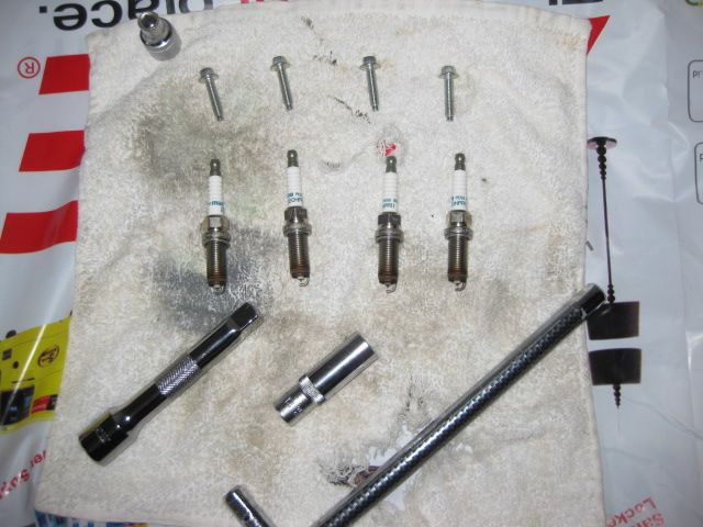

Tools :
1. 8 mm socket
2. 14 mm Long socket (spark plug socket)
3. Wrench & extension

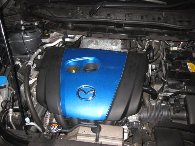

Step 1 :
Remove engine cover

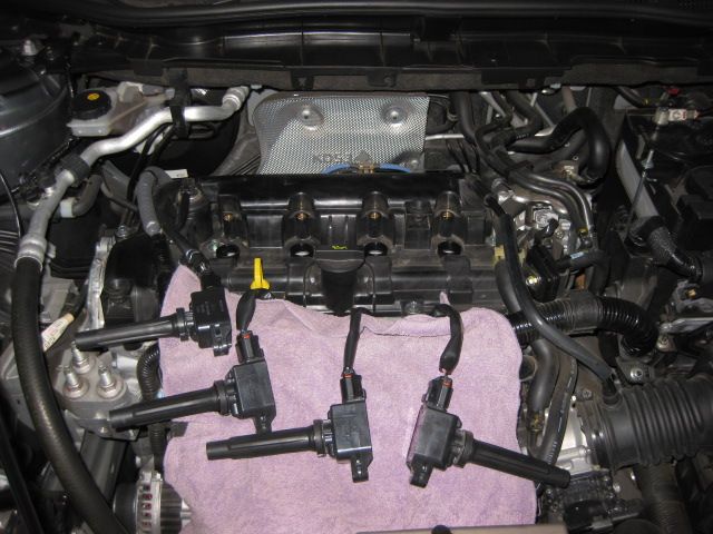

Step 2 :
Locate 4x 8mm nuts holding on the ignition coils
Step 3 :
Access the spark plug by using the 14mm socket .
Done .
