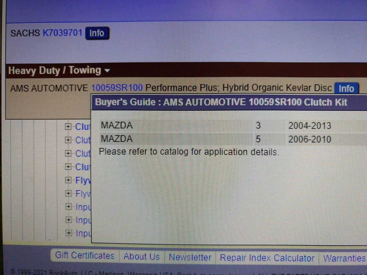

Hi from malabo, I have a Mazda5 2006. The clutch is bad and I've looked all over for one, please I want to know what car or mazda model clutch plate and release bearing can interchange to fit to a Mazda5?
Below is the kit I got from RockAuto. It shows other applications it fits.

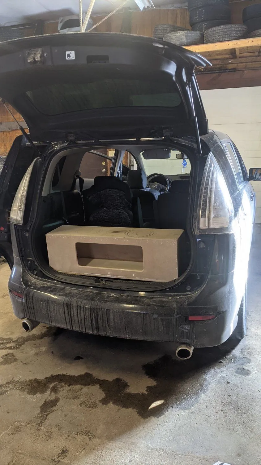

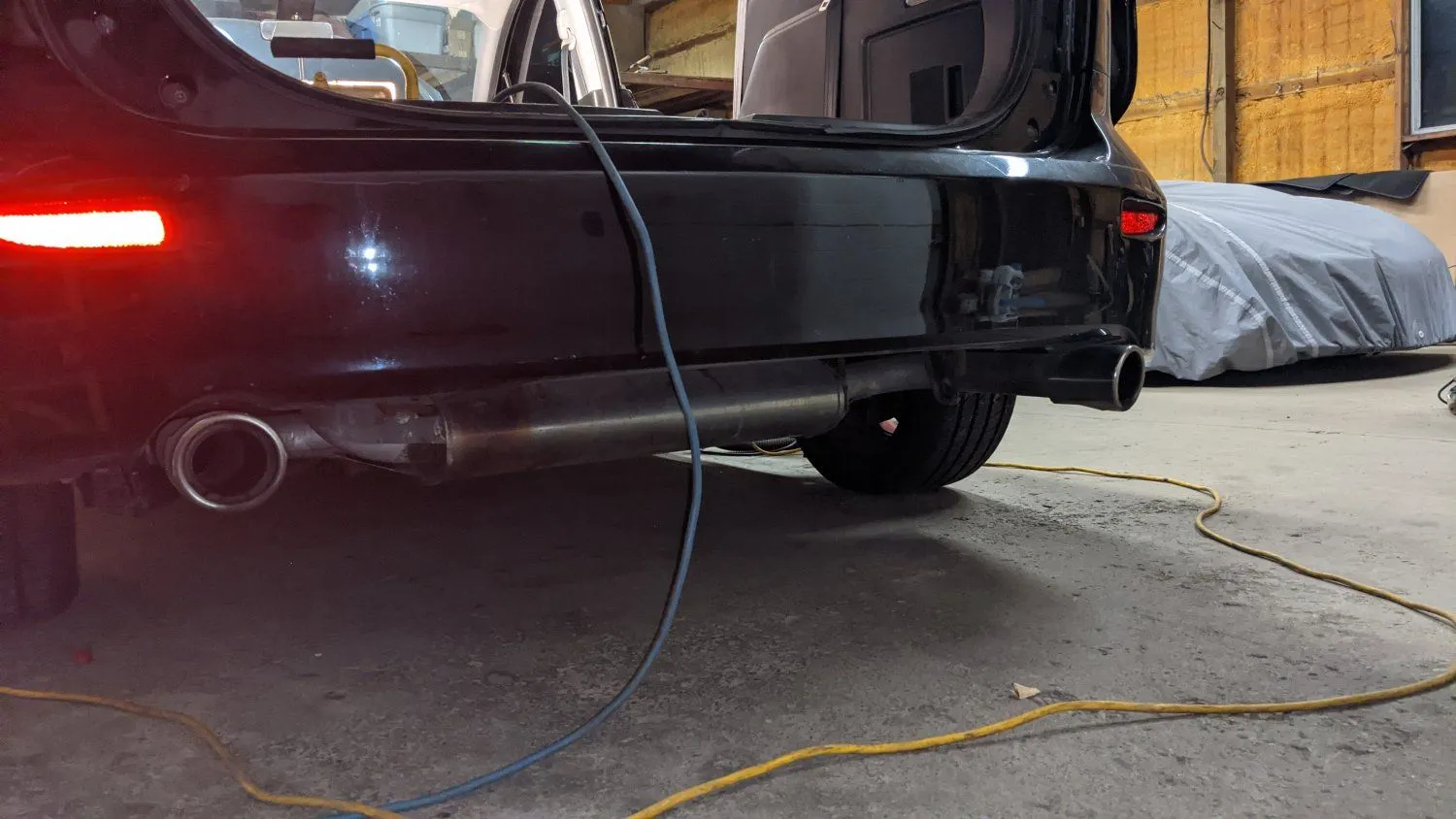

I can confirm the Mazdaspeed dual exhaust fits and bolts directly to the factory elbow over the rear frame. All that needs to be done is three extra hangers welded in to hold it up and you need to extend the tips as it about 8" to short to reach the bumper flush. Did it all my self in my shop aswell as upgrading the exhaust to 2.5" cat back.
This is awesome. I have an 09 m5 GT manual. I just might do this
Yup should work just fine. Mine is an 2007 5speed. This whole thing all together cost me only $160. Got the muffler used for $60 complete with pipe over the rear frame. Then $100 in piping and hangers to go 2.5" cat back. Welded everything myself so I saved bigtime there.
I will try to get a video on the exhaust on YouTube and post the link here. You gotta hear it lol. It's pretty loud when your on it but also quite on idle and I still have the res and cat on there.
I can confirm the Mazdaspeed dual exhaust fits and bolts directly to the factory elbow over the rear frame. All that needs to be done is three extra hangers welded in to hold it up and you need to extend the tips as it about 8" to short to reach the bumper flush. Did it all my self in my shop aswell as upgrading the exhaust to 2.5" cat back.View attachment 295309View attachment 295310
That seriously looks awesome. Well done.
