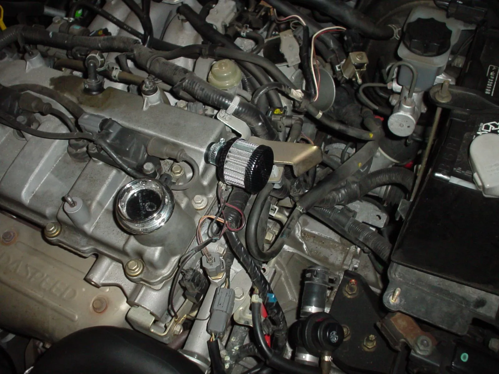

I got a cheap one off ebay and put it on when I did my hardpipes last weekend. The only thing I had to do was shave the engine cover a bit so that it would clear it.
