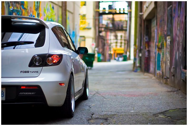

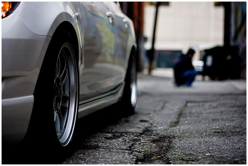

This car is 9" wide and 245. His offset is 45, I've heard speculation that he is running a spacer in the front to clear the strut. I can not confirm however.
Car belongs to Kevin aka dazed_and_confused from Canada.
