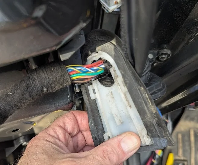

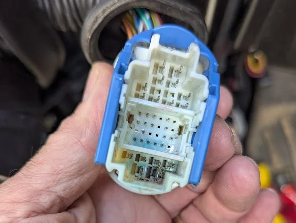

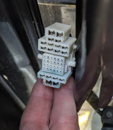

Water was getting into the driver's door harness, causing electrical shorts, which was keeping the ignition module energized. Took the driver's door card off, took the harness out of the door, and found all kinds of dirt and moisture inside of the harness. And, when I unclipped the door harness from the body harness, yup, mean greenies.

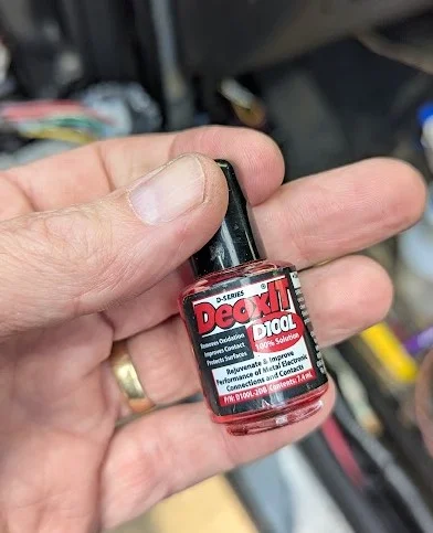

I cleaned everything with isopropyl alcohol and q-tips. Then I hit the mean greenies with Deoxit 100 and let it sit for about an hour.

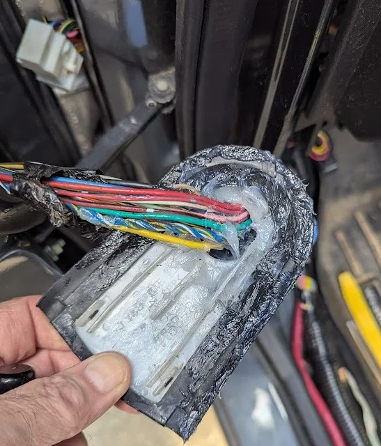

Before I put everything back together, I packed the door harness rubber insulator with dielectric grease to keep any water from getting back into the harness again.
