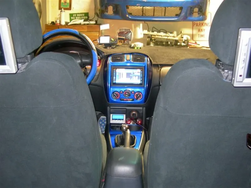

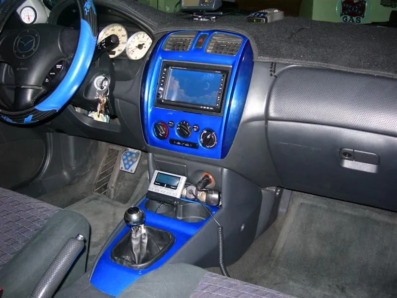

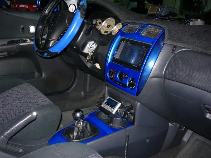

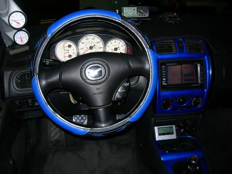

Simple commute to and from work today. Tomorrow.....
Thank you. One of they guys from AZMC made it for me.
altspace said:
That's quite the money pit Bill. Hehe...seriously though...nice work!
I don't ever want to know how much money I have dumped into this car.
ZoomZoom03 said:
which HU did u pick up??
Its a VALOR mulitmedia that I got from autotoys.com out of NJ.
