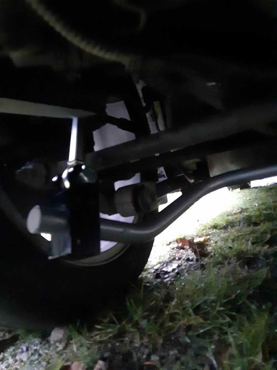

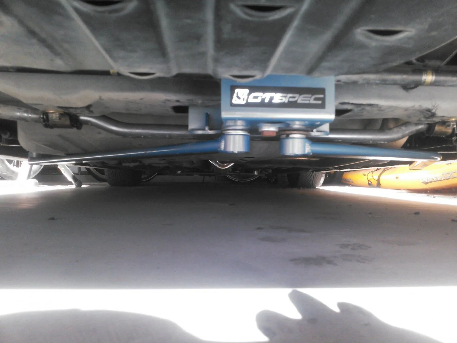

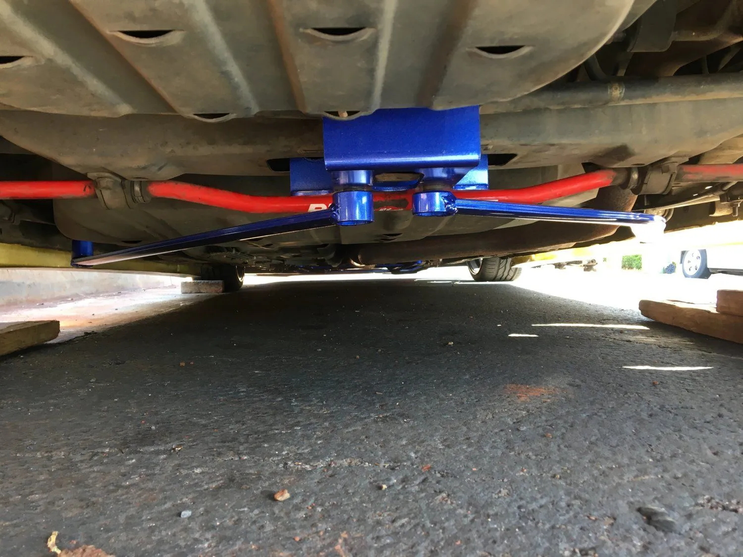

View attachment 226640Recently installed under braces
I see you had to use washers to space the bars for clearance too. I had to do same with GTSpec setup with Progress rr sway.

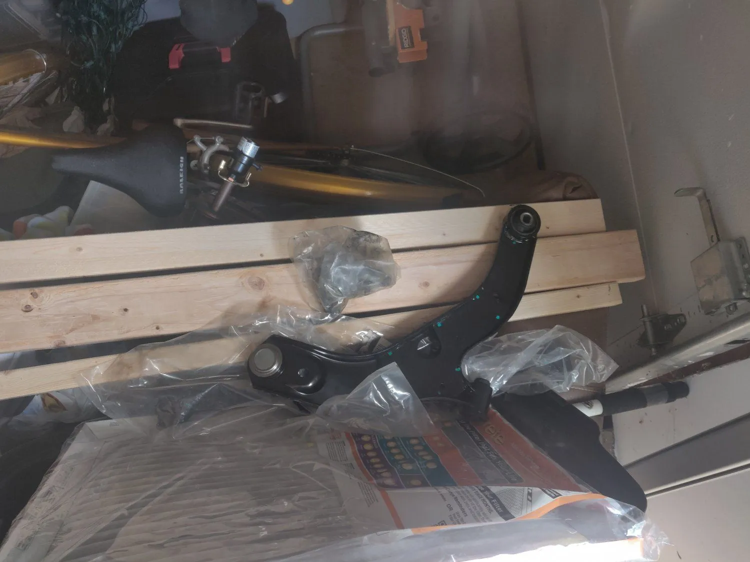

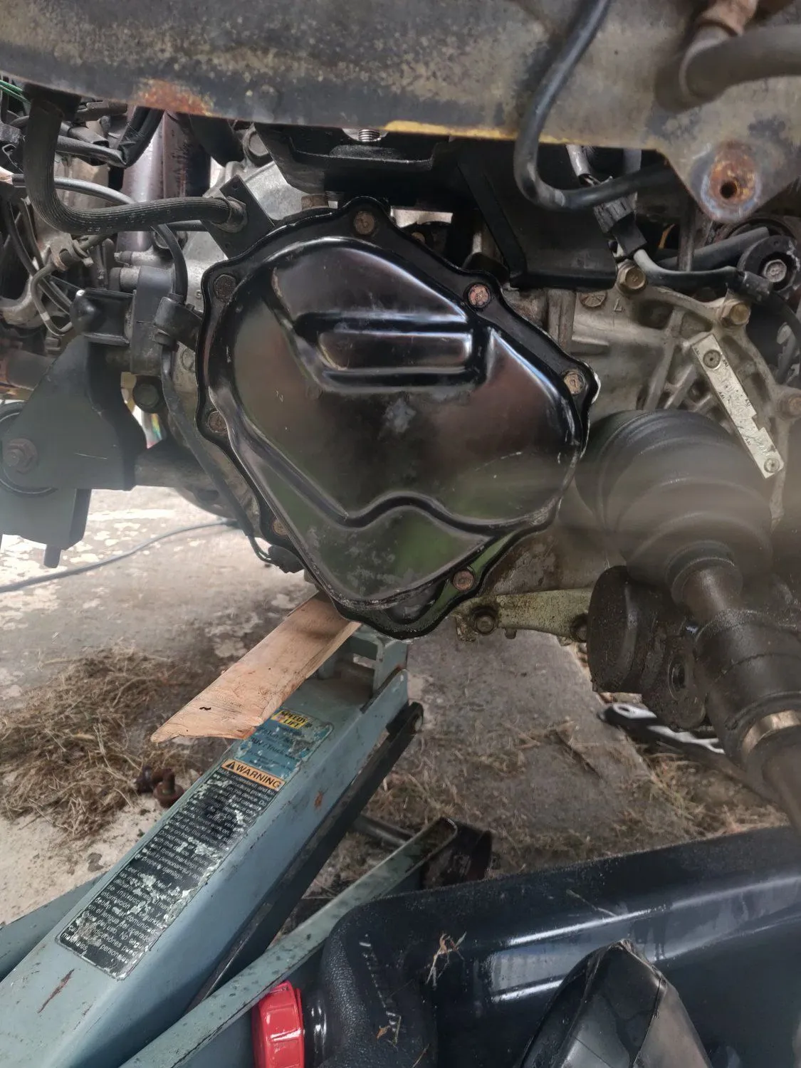

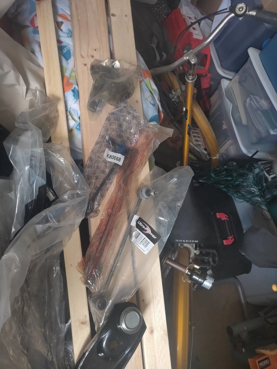

Control arms and rear trailing arms and front and rear sway bar links. Inner and outer tie rods...Also found a transmission leak from the side pan... Anyone know the torque specs on those bolts? Can't be much. They're 10mm. I'm guessing around 3.4kgf

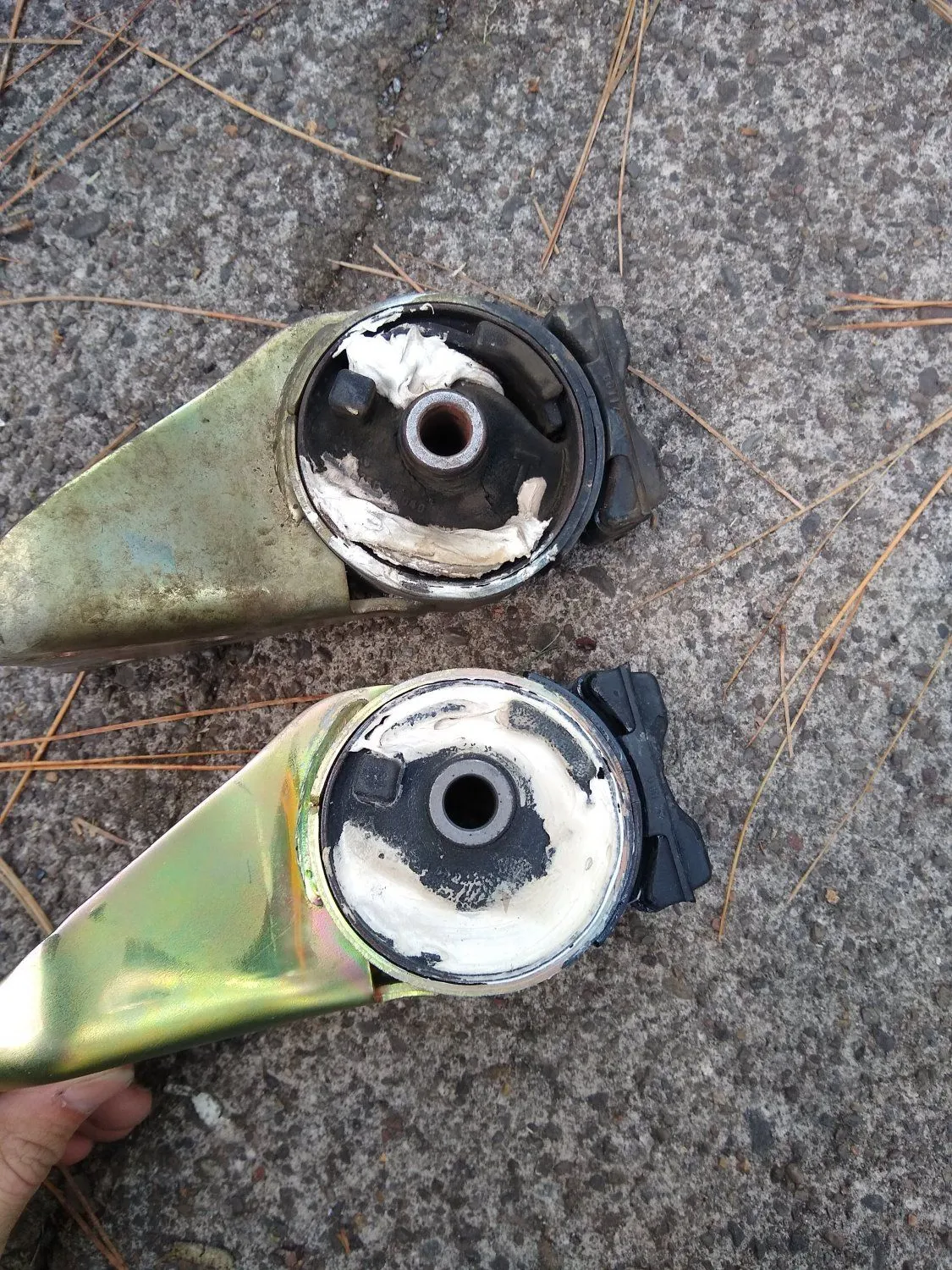

Old vs New mount (yes, the white Loctite polyurethane is ugly 😛)
I used an aftermarket in the rear before i filled one. It sagged after a few months resting on the bottom of the mount causing vibes. I got another dea mount and filled that one. Once its filled it cant sag lol. My front i barely felt with 90 duro inserts. Even with the awr sides it was minimal. But when i filled the rear with 60a i noticed the vibes. My passengers dont notice it but i remember how it felt stock so i know. I think filling another front will help and you prob wont even notice more vibes than now.
