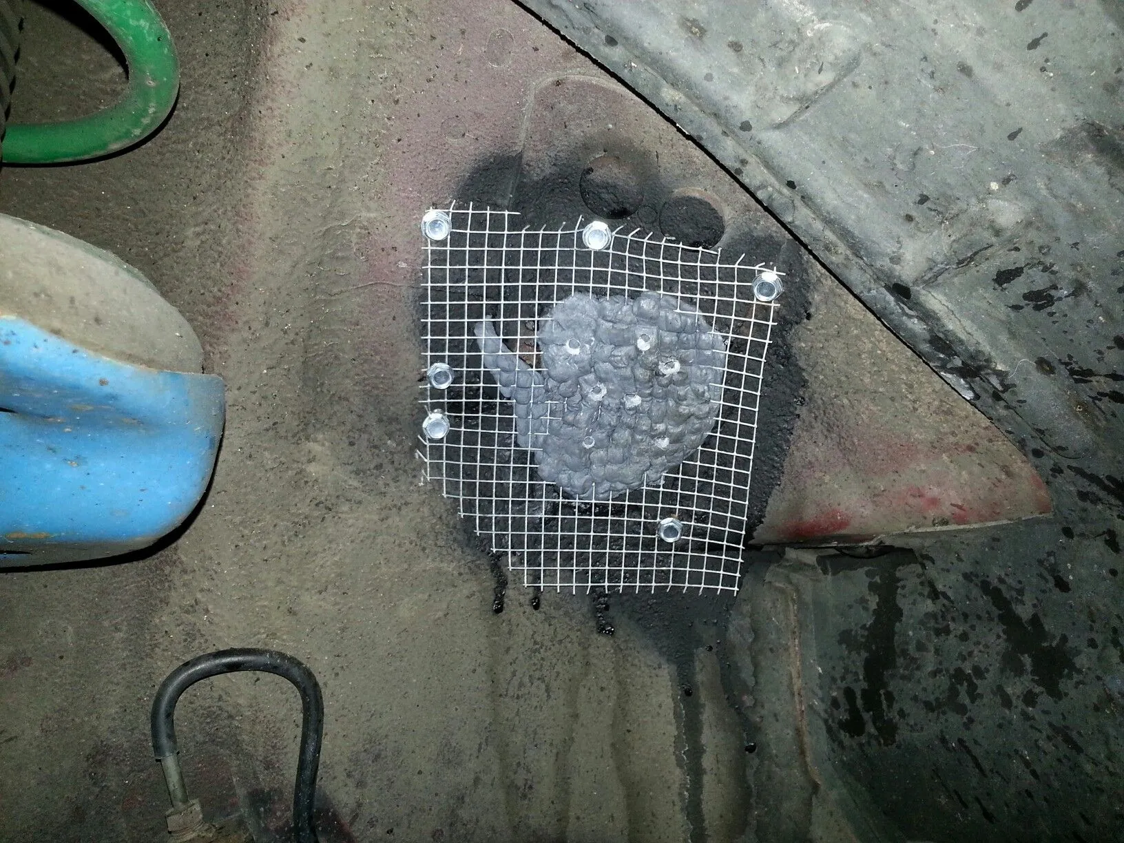

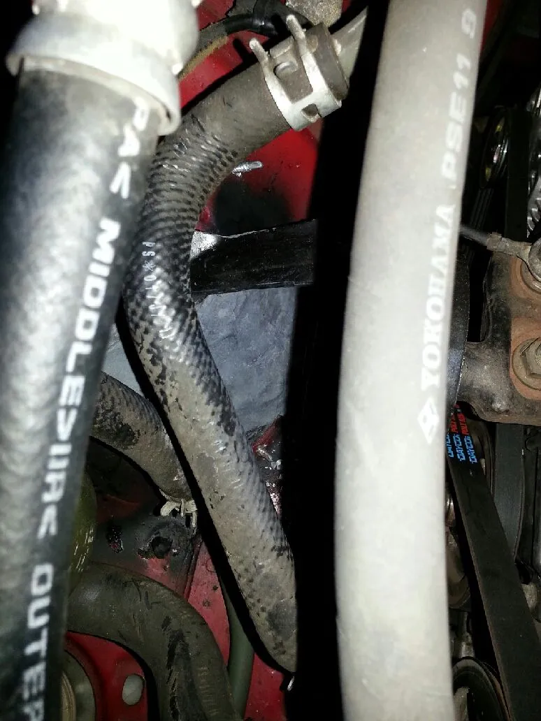

After changing the oil a couple of weeks ago and finding that the strut tower had finally rusted through, I performed a little surgery. Just hoping to slow the progress down a bit so I can squeak a few more year out of the car. Took a screwdriver to knock out the majority of the rusted metal. Next, hit the edges with a wirebrush and cleaned everything up. Then I sprayed some Krud Kutter Must for Rust on the engine bay side and wheel well side Once that took effect I hit up both sides with some Rustoleum Rust Reformer. Next I attached some 1/4" hardware cloth from the wheel well side to give the epoxy a little something to stick to. Added two tubes of Rectorseal EP-200 Epoxy on the engine bay side and smoothed out the best I could with the hoses in my way. Today I bought some Rustoleum Professional Grade Undercoating which will be applied on the wheel well side. I'll sand down the epoxy a bit to try and smooth out more and then hitting that with more of the rust reformer.

Rectorseal Epoxy in place
attachment.php
Wheel well side
attachment.php

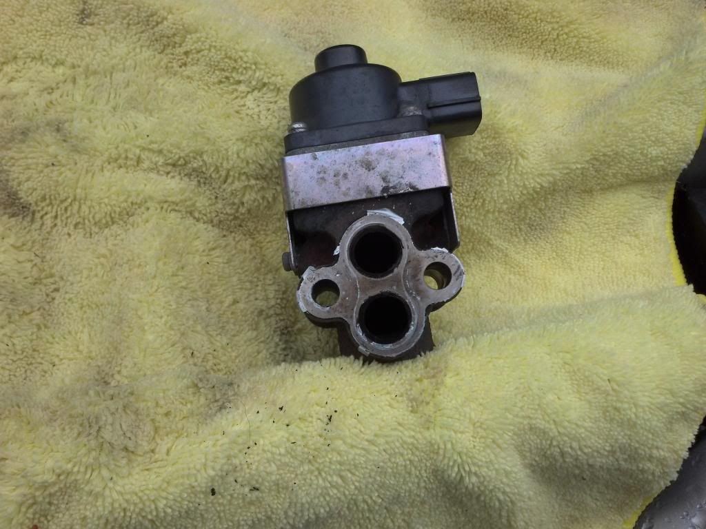

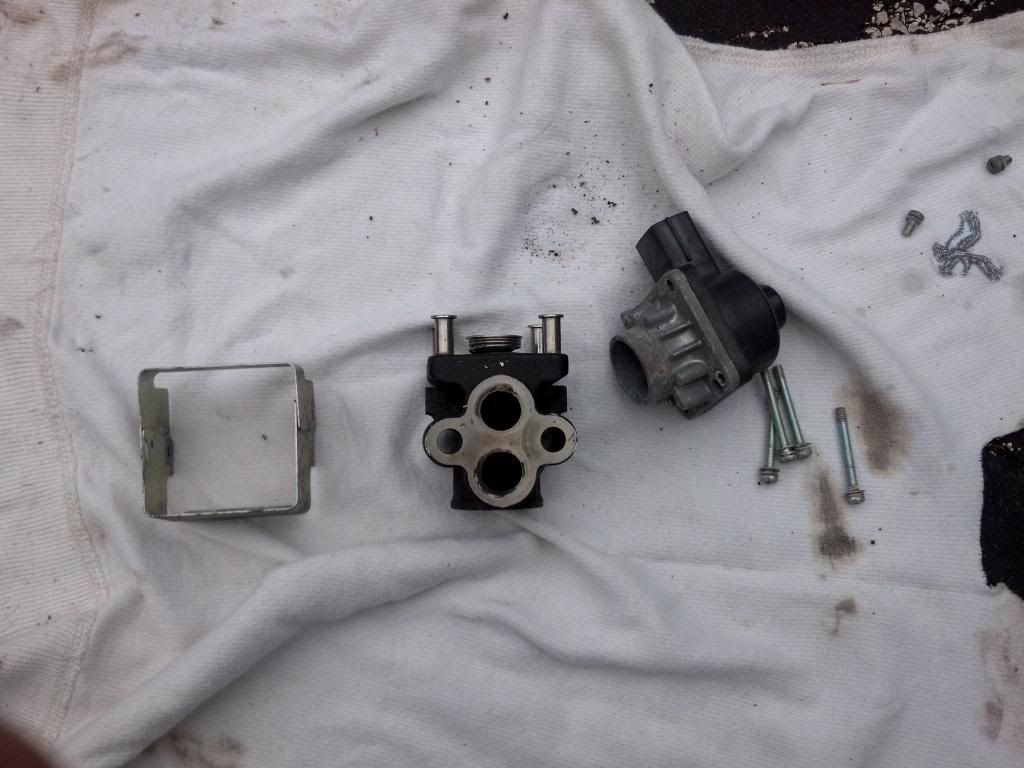

EGR is cleaned and lubed, but I still bought a new one as a backup. Fixed the problems though... of course.
It actually wasn't all that bad. The inside of the valve just had some surface carbon, nothing really built up.
[/URL]
It was actually just some carbon on the shaft that needed cleaned out and lubed back up.
