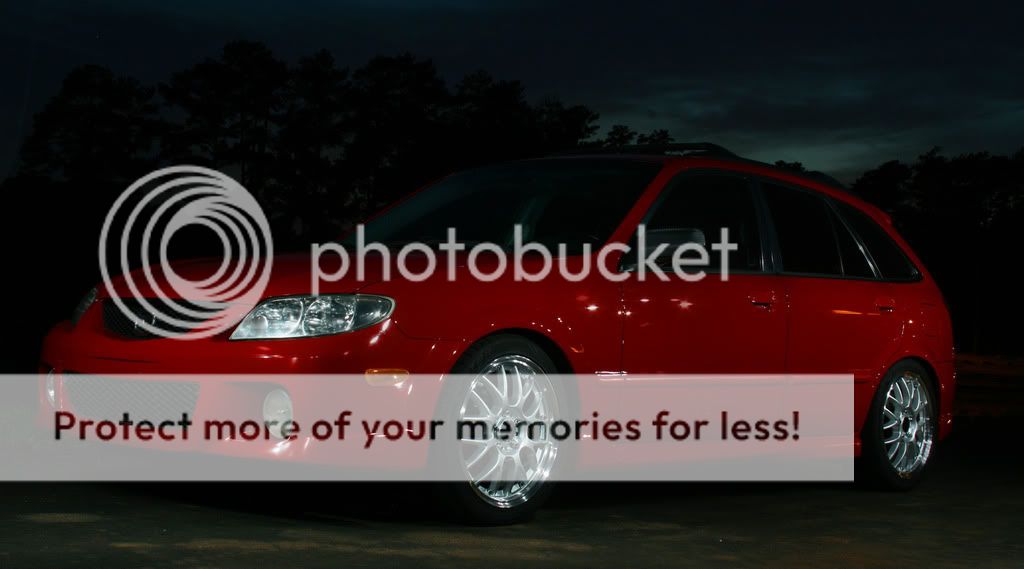

Do want. :) the rim I see looks nice too :) care to share specs? Im no gonna be getting any anytime soon but was just wondering :)
