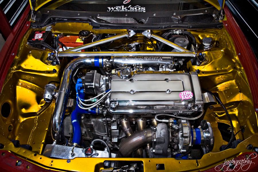

so im deciding to do a wire tuck.... kinda... i am tired of having wires everywhere and my engine bay not looking.... well acceptable to me...
im starting with this
goal
( i know it is a honda )\
^^ that is a mil spec cannon plug adapter.... all your wires go into one side from the ecu and your engine harness on the other... it allows for simple removal of components... you unplug one thing and poof no more wiring to fire wall... makes pulling the engine a breeze
^That's neat... Good luck with the wire tuck, bro. It is very tedious work. I look forward to the end results tho. Clean engine bays are win.
^^ lol i know... i want it to look... pretty... for lack of a better word i need a better job though... cause right now i aint got s***..
I'll be interested to see the results of the wire tuck. Anytime i see an engine with the wires hidden it's a weird and cool sensation.
"Somethings.......missing. But what? I can't quite put my finger on it....but man that engine bay looks sweet!"
my plan is to take all the sensors and leave them in their location and rewire everything... find out what goes where... and color and number code it... have all the wires a and cables go from their locations under the intake manifold... however i have no idea where im going to put the fuse box... im retaining cruse control... so it may or not be possible.. ( i realize anything is possible with time and money... but im lacking the money part)
