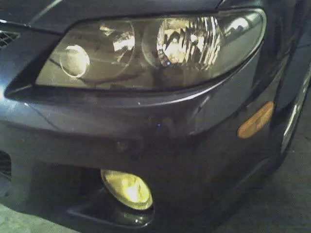

There is just a small nick in the paint on my rim. That can be touched up.
Allignment is still good. The headlight hit the rail and was pushed back into my inner & outer fender.

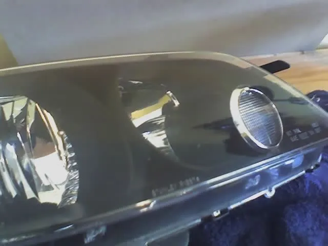

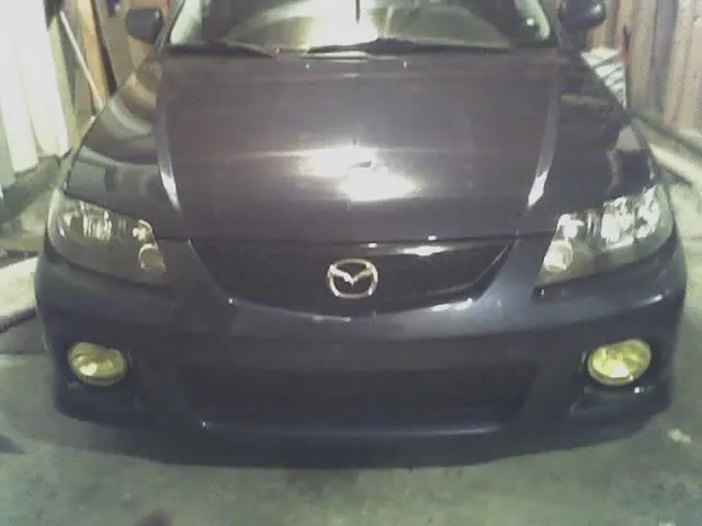

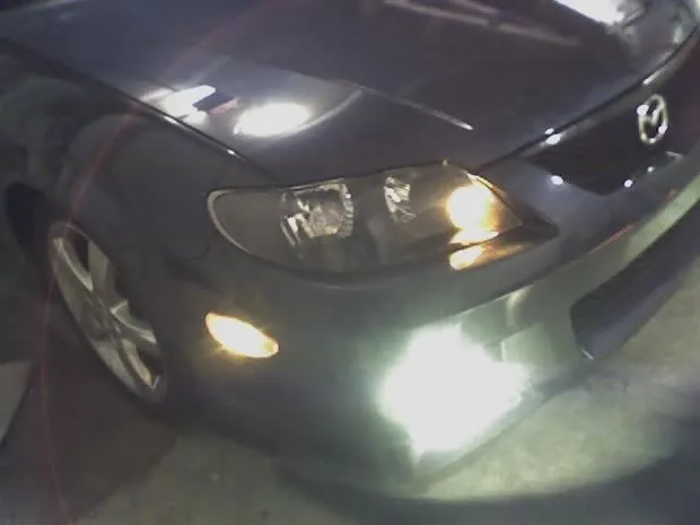

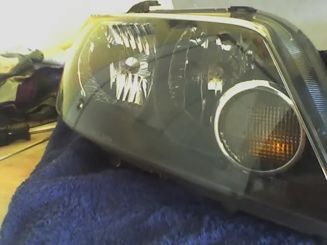

Headlight black out
Just blacked out the headlight bezels... Turned out better than I thought it would. Since I used 1200 degree black with ceramic in it, it kinda has a satin finish, instead of flat black. I used this how-to:
http://www.msprotege.com/forum/showthread.php?t=114394
One thing I hated about this mod is how the turn signal surround is also painted. To me, that just doesn't look good- I mean, the low and high beams have chrome around them, why shouldn't the turn signal? So with some very careful masking, I was able to keep it chrome. Sorry for the crappy pics- best my camera phone can do. I may be able to get some better ones near sunset tonight.

that looks really good with the chrome surround... I might do the same when I paint my headlights.
Thanks, Breeegz. It required about 30mins extra per light to mask it off, and a hella sharp knife, but it really wasn't as hard as I thought it would be. My advice would be to use small strips of tape rather than larger ones, and overlap by 50%. And, like always- it looks so much better in person than in pics. I really wasn't sure how much I would like the mod, cause i didn't want flat black- but I did want high heat paint. I used "Duplicolor High Heat with ceramic" black- #DH1602, and it has a nice satin finish. I put on abour 4-5 thin coats, which produced very nice results.
good job!! the pics are a bit crappy, but it looks like you work is first class!!

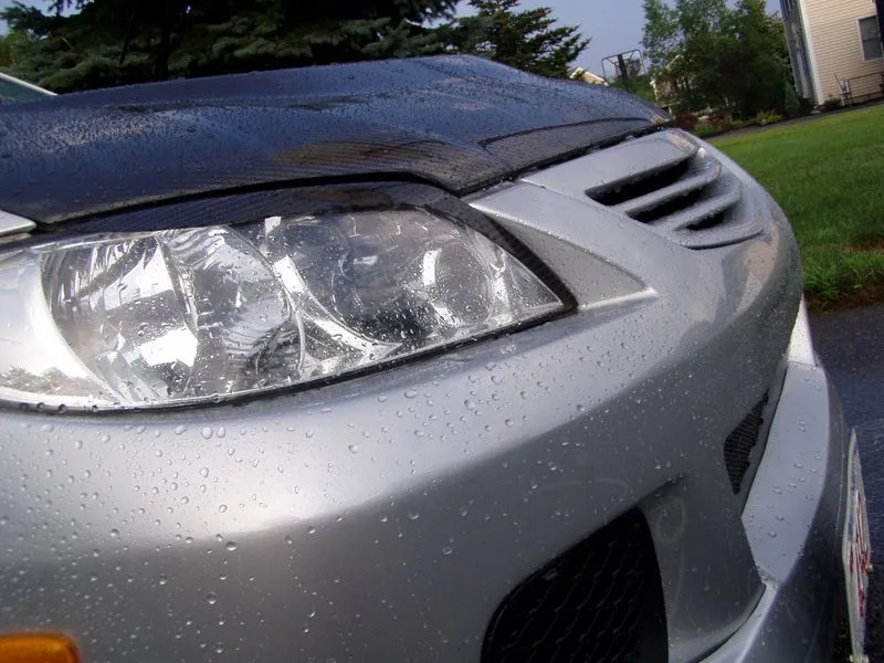

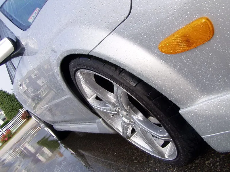

gave her a bath.....nice and clean again!
