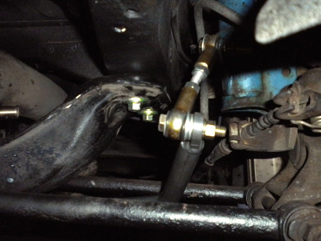

Lol we did learn that the hard way for sure. Glad to know it's on there right now. Anyway, here are the pics. Excuse the dustiness of the cross-member and the rust on the brake parts (didn't wanna spray those with undercoating). I think that cross-member sat in a warehouse for ages.
Endlink

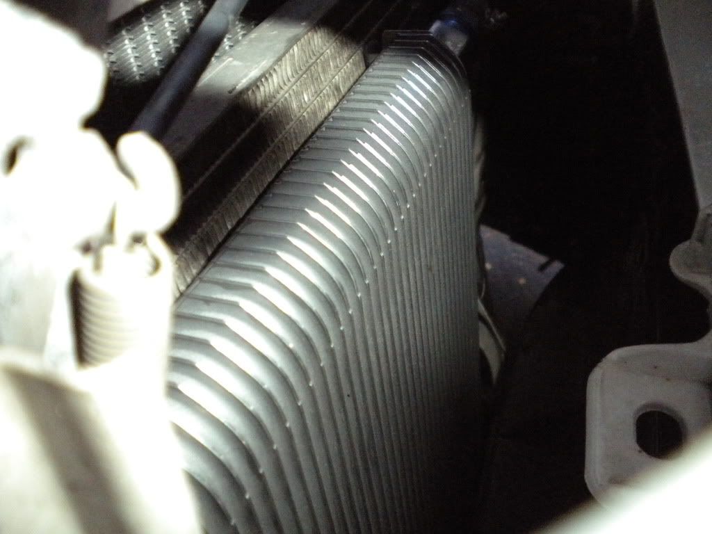

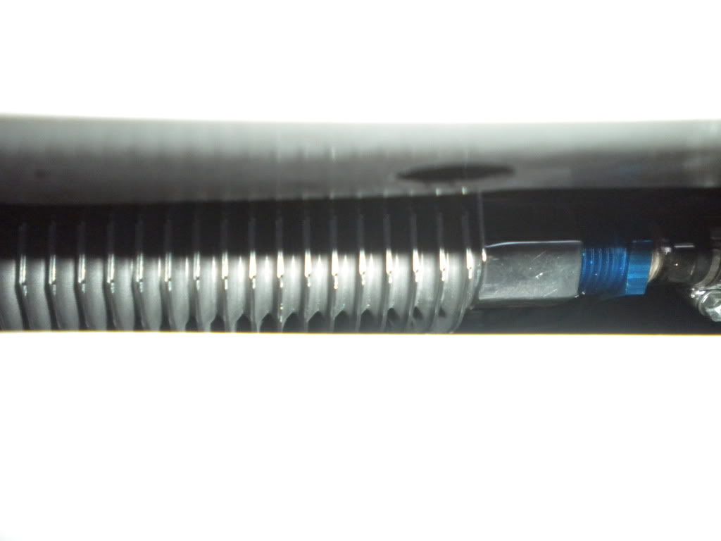

Cooler (I'll get the grille off one day and take a better pic.)

Yep I sure did. Antonio, make sure to check that the sway bar isn't compressing the lateral link bars (as seen in the pic right below my endlink) when you lower the car down. I had an issue with that and had to cut the endlinks almost 2 inches shorter.

They looks awesome! lol What length did you use for the all thread? Im going to make some rears soon. I only have the front done.
Originally I made the links stock length since the stock length worked with the progress initially. For some reason, these aimed the bar lower down and once we lowered the car, the bar was pushing down on the lateral link REALLY REALLY hard. If I would have driven it, I would have bent both of those bars. So we cut it down a couple inches to I'd say about 4.5". If you want, you can add the pic to your thread :D

oh ok, yeah i am gonna put the sway bar on first and see how it sits when its on the ground then measure and hopefully it isnt compressing the link bars...
