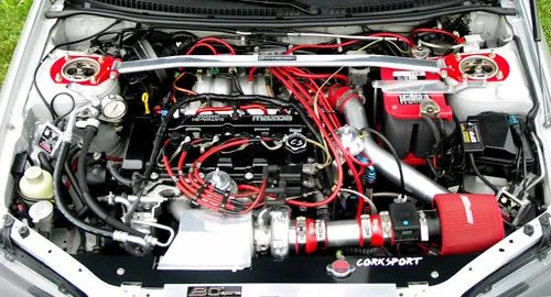

Well with the fabrication techniques of today. Im sure if you got the cash flow you could put it in. I dont think it will bolt up though...lol
There is always a chance...There are some crazy swaps out there. Im sure if you find the right shop in your area, they could do it for you.
eh, I'm not gonna do it first.. its too much of a PITA..
although I'll bet a "mazdaspeedprotege5 3" would scream..
