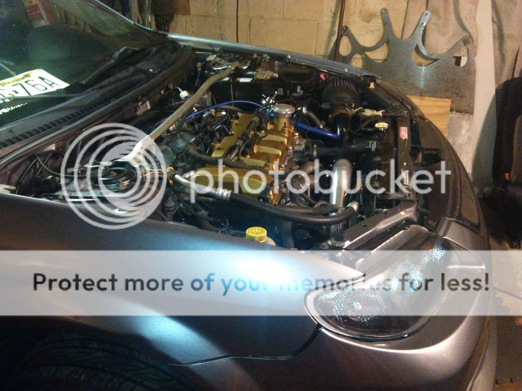

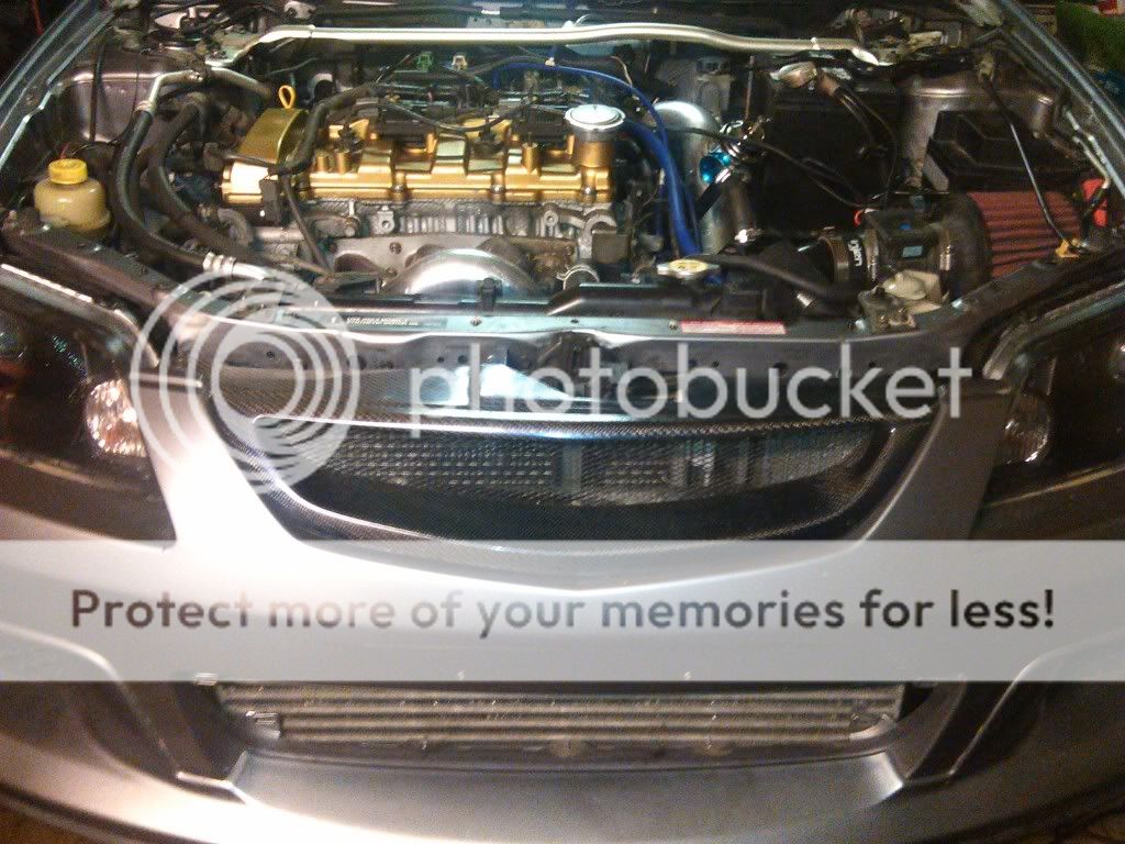

Finally Dropping In A Fully Built Block & Welded LSD Trans. K1 Long Rods, Wiseco Pistons 8.8:1 Comp. Spec Stage2+ Clutch, Fidanza Flywheel, 5 Angle Valve Job Head Rebuilt W/ OEM Valves & Seals
FIRED UP ON FIRST TRY! (cabpatch)
This was my project all day saturday. Went to Outlawstar89's house along with 2 other buddies took us about 12 hours to do the swap. Damn rear motor mount was a PITA to bolt back up and lining everything up with a new AWR trans mount also was not fun and killed about 3 hours for us just lining everything up.
