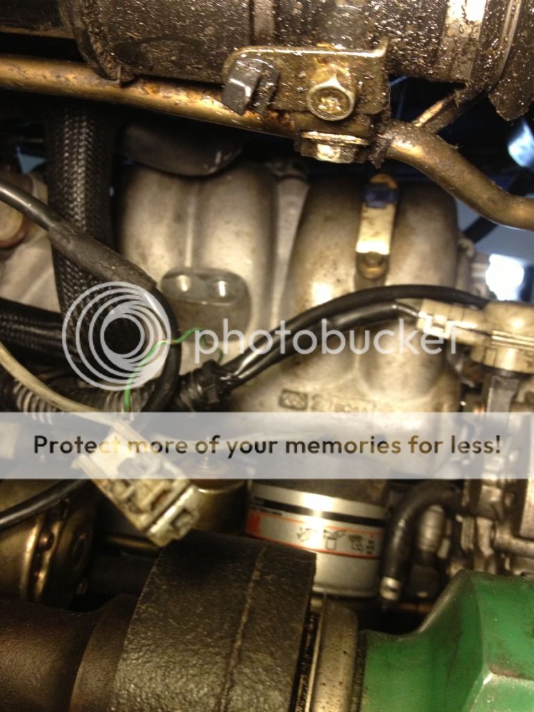

Funny you say that... Looked over everything last night and found this wire not plugged in, it comes out of the wire harness with the wires for the alternator, I looked all over and can't find out where it goes. It's a green wire with a red stripe on it
It looks like it was for the oil pressure light. It also looks like you've removed the oil pressure switch and installed an oil pressure gauge?
Took a pic of mine so you can see where it goes. Of course if you removed it then yeah, wont be needing it.
