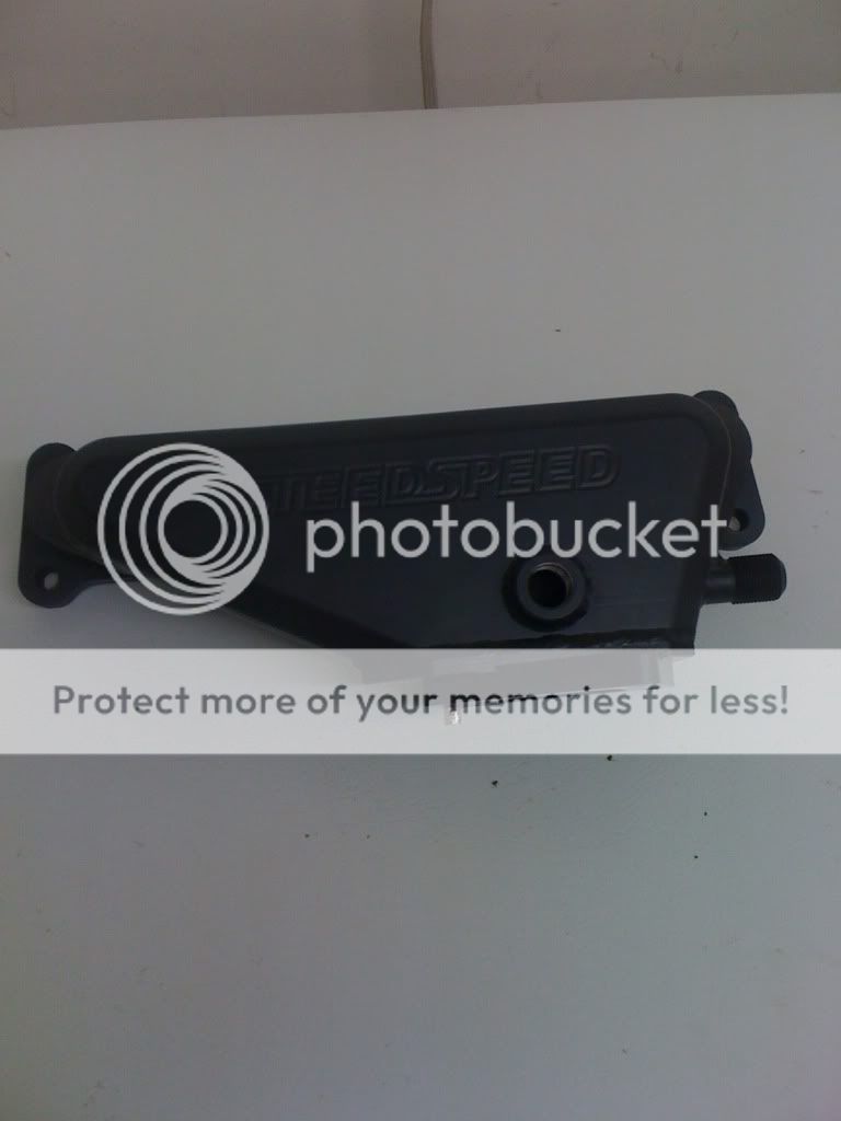

Got this today, I just need to get the broken stud out.
