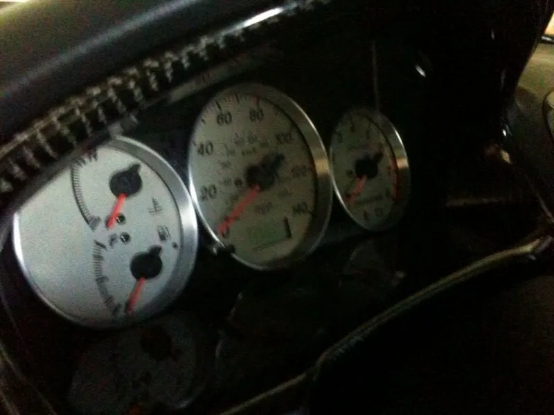

More carbon Installed! (cool)
Who needs a motor when i can make everything carbon fiber and just pick it up to move it? gosh your such a noob!
