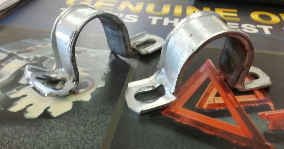

These are for a 32MM bar, OEM will not work with the bushings and bar I have installed.
Cleaned the EGR system, no CEL for a week or so. Hooray!
Going to replace sway bar bushings soon.
Okay well that makes sense then ...they definitely looked like they are not as heavy duty as the OEM ones...
Yeah, the brackets supplied with the Moog K7326 are clearly junk.
