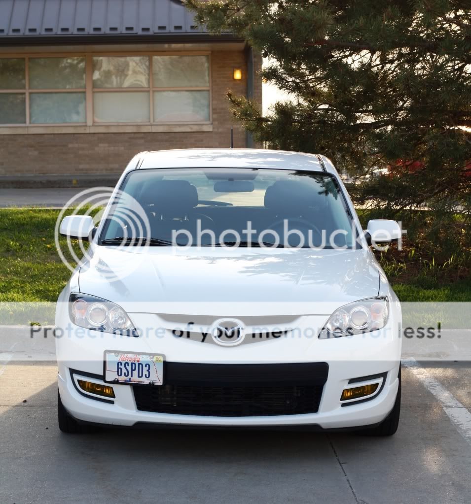

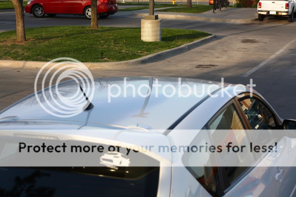

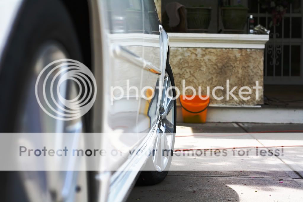

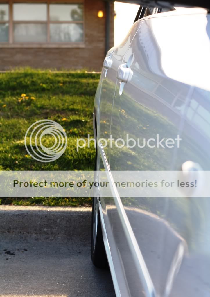

Tried out a new wax today. FK1000p high temp paste wax. Supposed to be extremely easy to apply and remove. It was. Applied in part sun and removed in part sun. Literally effortless. Supposed to wait 24 hours between coats so I'm going to throw another coat on tomorrow.
As it stands now:
Anyone who has a white car knows it's hard to get a good reflection, well I think I've got a good one!
