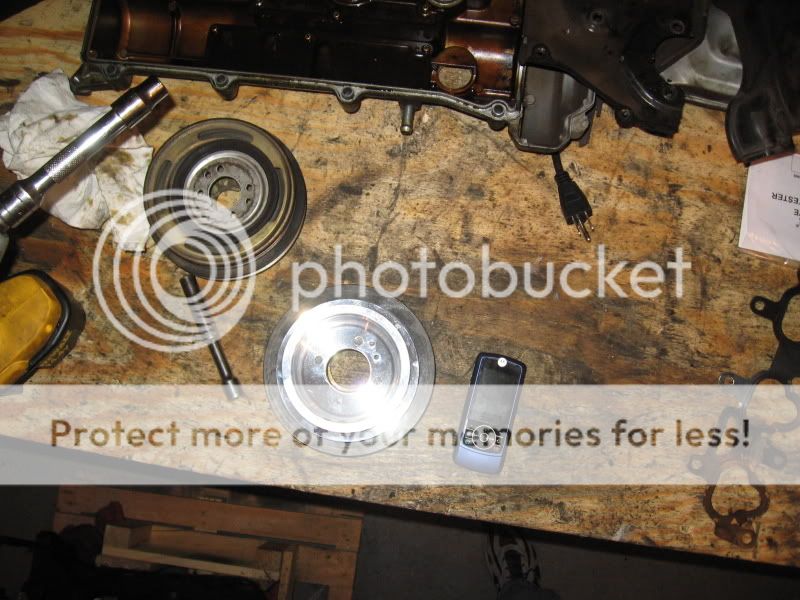

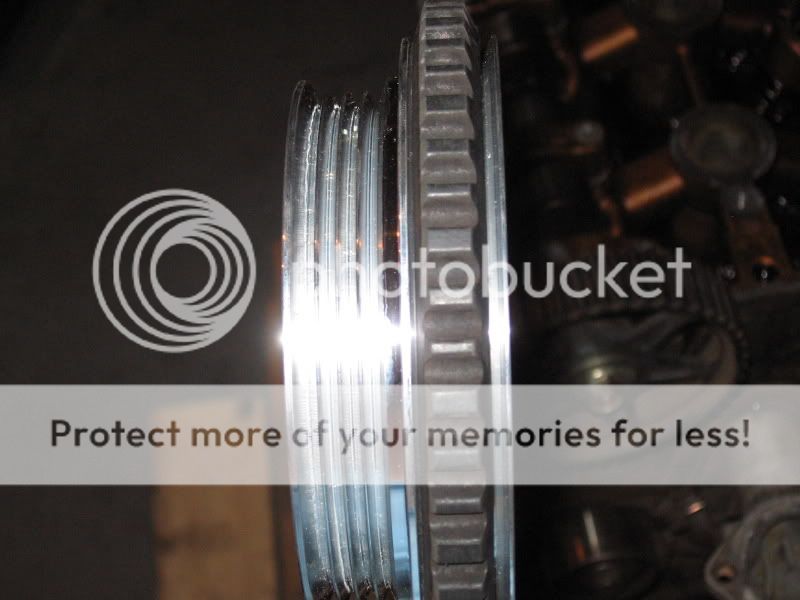

However, I've hit a bit of a snag... I have 2 UR pulleys (I got a freaking steal... better than 2 for 1 for brand new UR pulleys!) One fits the big nose crank my car has, only problem is it's for a 1.8. This is VERY similar to the 1.6 pulley, however the belts are different. IE, on the 1.6, the WP / Alternator are a V belt, and the power steering is a ribbed belt (for her pleasure?), while on the 1.8 pulley, they're both ribbed belts. The other pulley fits a 1.6 long-nose crank (the 'new' 91.5 fix, which the spare motor has), and has the right belt types for my accessories, however it doesn't fit over the crank. Oy...
Here are some pics
Here is the washer from the big-nose pulley over the hole in the long-nose pulley for a size comparisson.
The one on the left is the long-nose (which doesn't fit), and the right is the big nose (which fits, but the belts aren't the right type...)
Here is the UR big-nose pulley on top of the stock big-nose crank for size comparison.
So I had an idea, and I have no idea how stupid it is... so please tell me so I stfu if it's retarded.

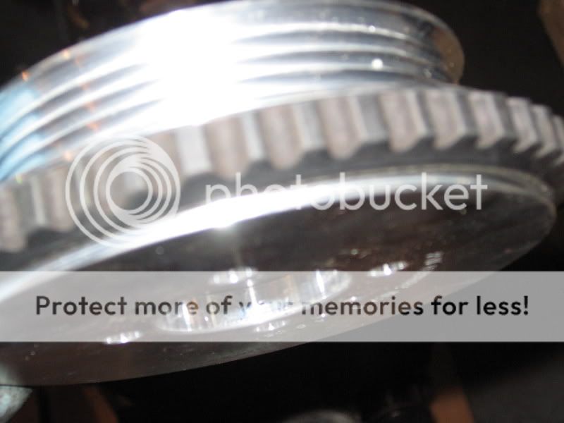

How dumb would it be to run the accessory belt upside down? It seems like in my head it would work, but I have no idea how susceptible to it, oh I don't know... completely coming undone... it would be.
Upside down V belt on ribbed pulley
There's a little gap there, but maybe I could find a wider V belt? Only problem is that then it definitely wouldn't fit the accessories
Any ideas? Or is this going to be one of those "Wait til you get the new engine in and put the right pulley on" situations?
You can always swap the WP pully and alternator.
