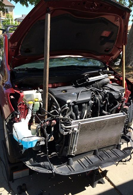

Also noticed I need to replace my radiator support due to the right upper mount being damaged from a run in with a deer; the support is just reinforced plastic, it has 6 mount points but the two upper mounts carry most of the weight. Ordered new OEM support $290 free shipping, should be here by this Friday. It sucks but at least I know its a pretty easy job.
