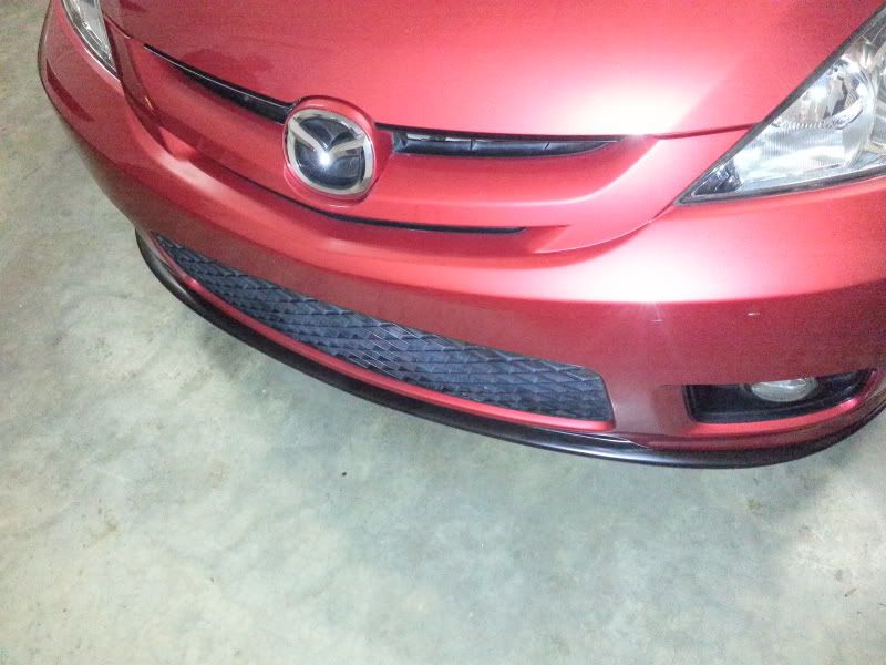

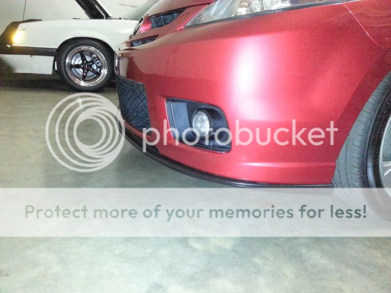

Removed the old splitter I had and installed a smaller gentler one.I'm still on the fence about painting this one but I will see how it grows on me.

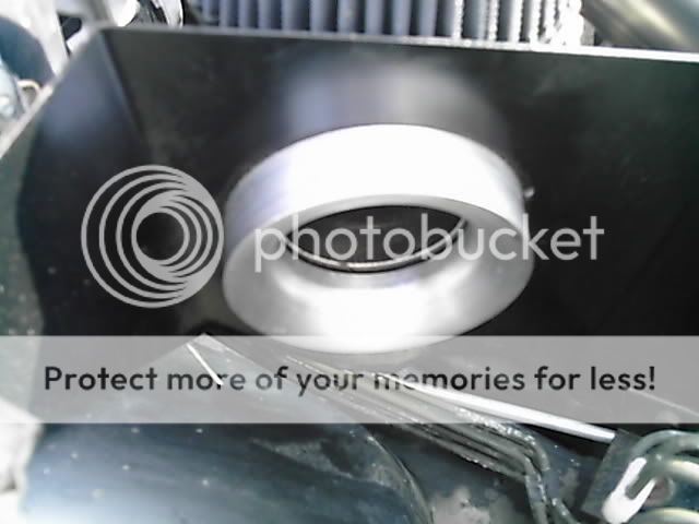

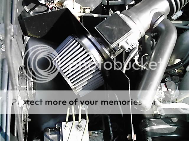

That's what I was referring to. But it also has a lot to do with design of the tubing and placement of the filter. I had a TurnOne intake on my fresh-off-the-boat-from-Japan 1998 Subaru. No loss in torque and screamed on top. It had a pretty cool whistling sound too. But it was very non intrusive, only removing the airbox and adding a shield and a cone K&N filter over a billet horn
So I still got the original piping bring the fresh air up from under the car and I still have the stock tubing from the MAF sensor to the throttle body. It worked out very well for 167,000 miles. I sold the car in 2008 on ebay.
