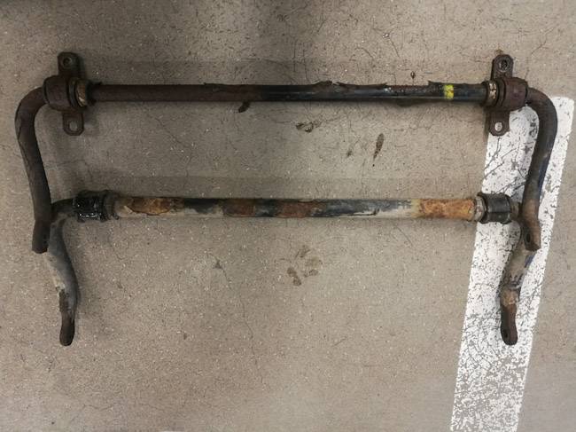

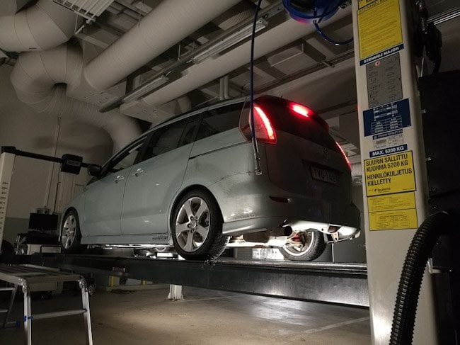

I changed swaybars. Got nice deal for MPS3 swaybars, front and rear.
Rear was easy, but front was little pain in...
But now it's been done and also wheel alignment.

I'd actually recommend upgrading the rear only- doing both will bring you back to understeer again. Rear only makes the handling fairly neutral, especially with the spring setup I chose. Looser front sway (factory piece) will give better turn-in.

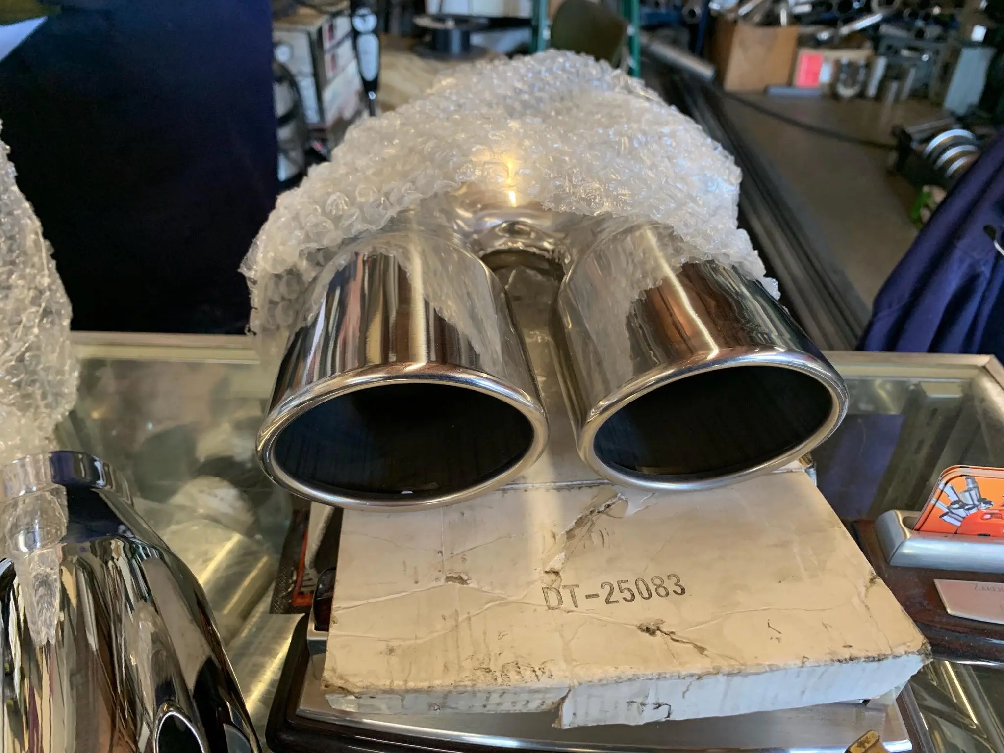

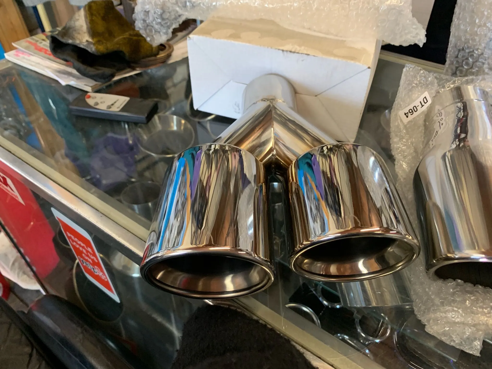

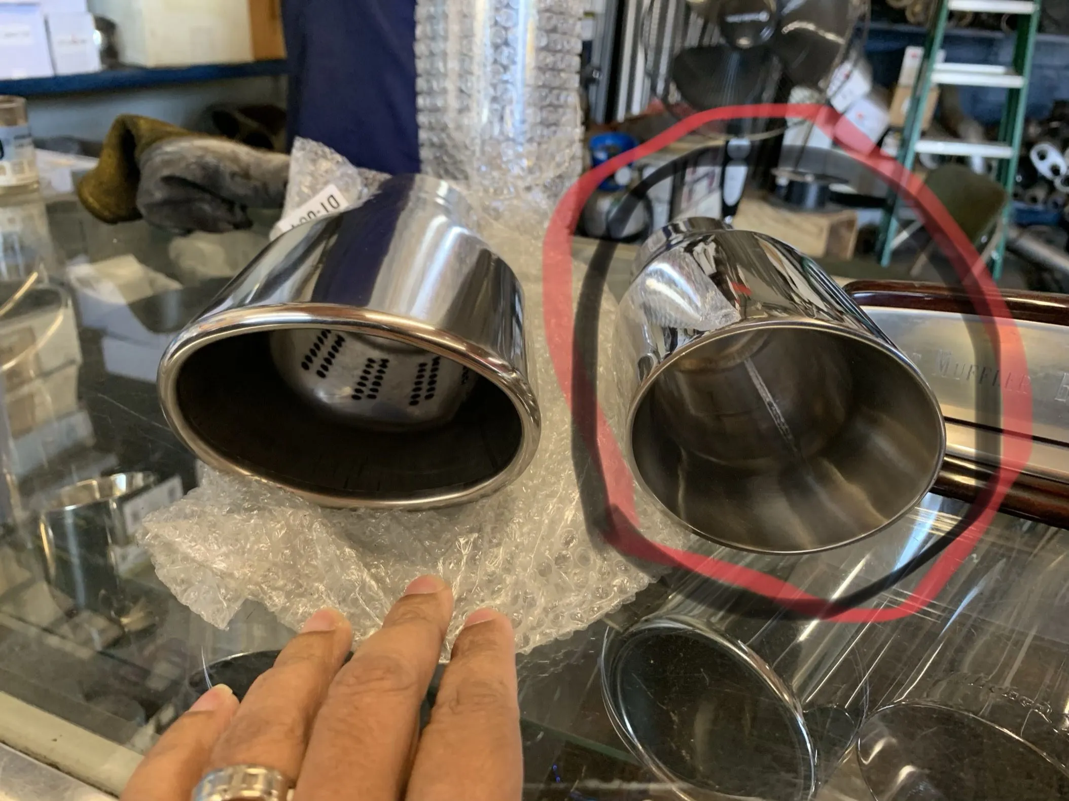

Thanks. Haven't decided on which one. The shop keeps wanting for me to do a DUAL. I prefer the single. Will have it done in the morning. $40 for a tip+install = can't beat it.

Can't really make it look prettier, the bumper shape is not intended to fit any exhaust except the factory dinky tiny tip. Already spotted a staggered h shape tips that might potentially look better than this.
Click on "dual 1" link above your post, it is a staggered H the shop showed me.
