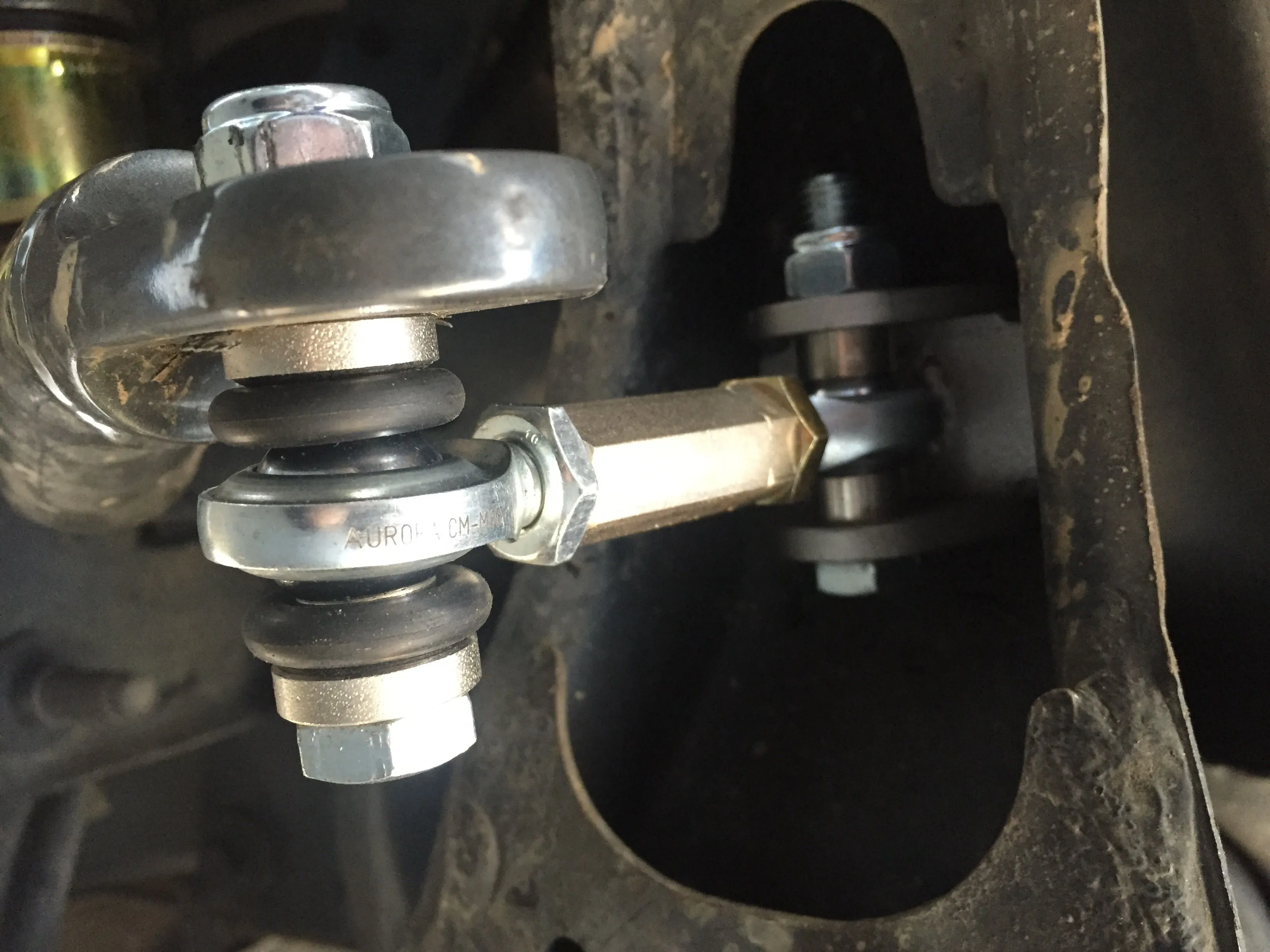

AWR rear endlinks installed onto the Progress 32mm MS3 bar :-)

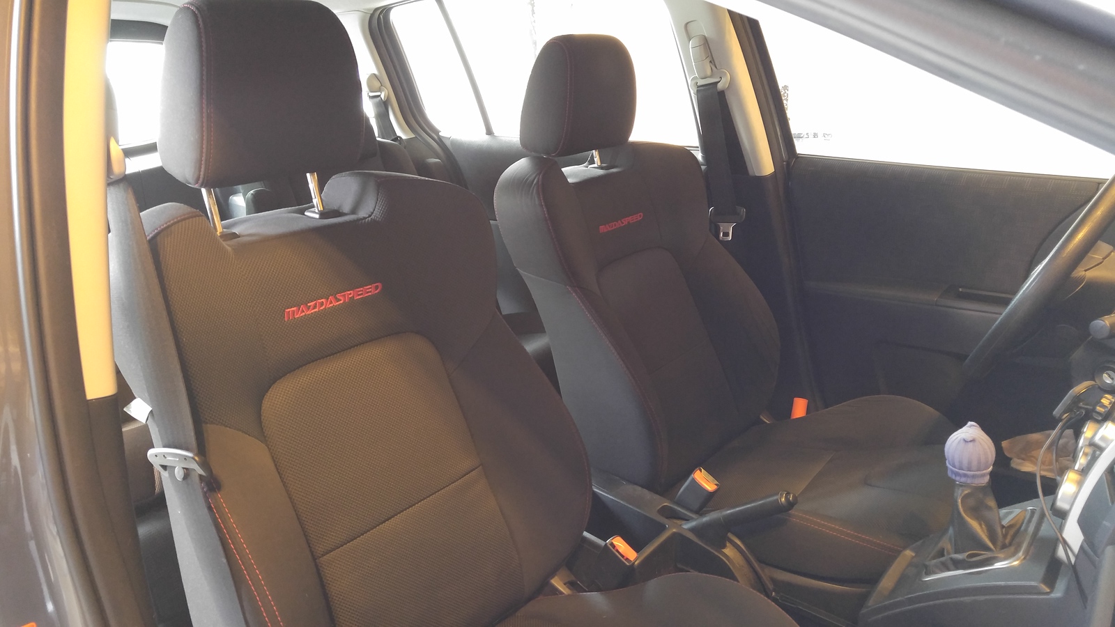

Finally got the passenger side Speed3 seat installed, two months after the driver's went in:

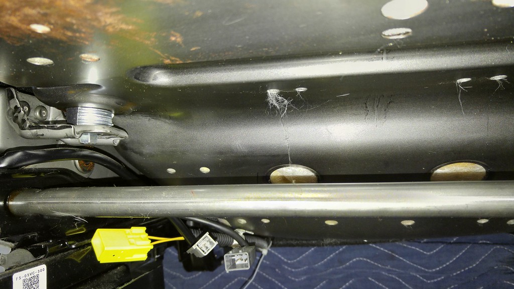

..Also pulled the driver's seat out again and raised the front using washers and a longer bolt between the seat pan and the base:

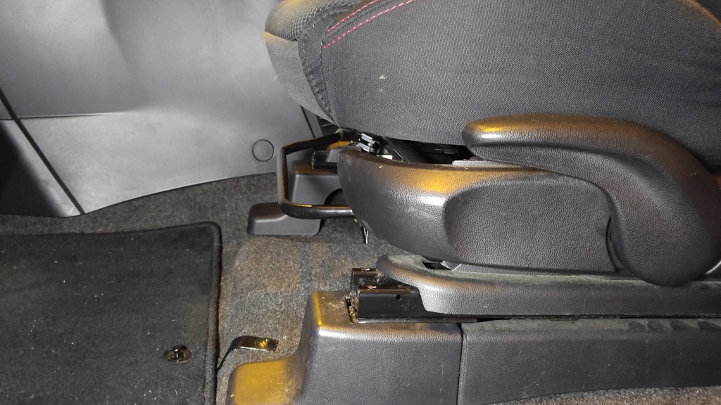

Raised the front probably an inch or more:
The tilt it gives the base feels much better so far. We'll see how it is once I get more seat time with the new configuration.
Were you having issues with thigh support? I ask because that is my principle issue with the stock seat, and would switch to the Speed3 unless it fails to solve the problem. My issue stems from the fact that the OE seat is 10 years old and the foam has collapsed in the base. It has actually gotten worse in the three years I have had the van. I gotta go to CarMax and sit in a Speed3 to see if the seats suit me or not....
Yeah, it took a while to figure out exactly what was making me so uncomfortable, and eventually I realized it was that I felt like I was almost falling off of the front of the seat, plus fatigue from essentially holding my legs up in the air above the clutch at all times. The Speed3 seat base is about an inch longer, which doesn't seem like much, but it seems to help. I think your best bet would be to try the spacer trick to raise the front of the seat. That seems to make almost as much difference as the longer seat, to me at least.

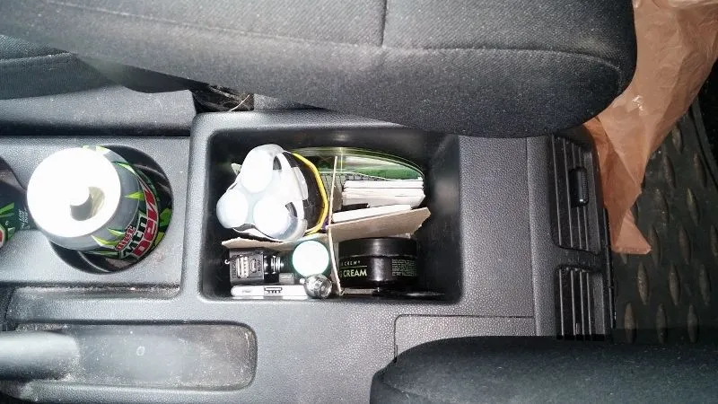

After being frustrated over not being able to find stuff easily, I finally made a divider for the storage space between the seats. Just used a bottle divider from a 12 pack of beer, measured the bottom dimensions, and cut
