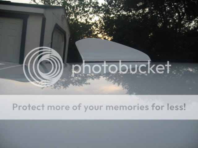

I finally bought and installed a Sharkfin in A4D, Rally White.

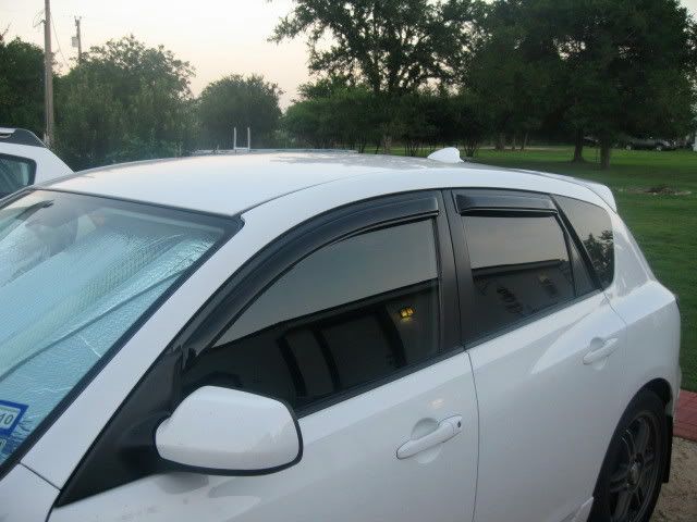

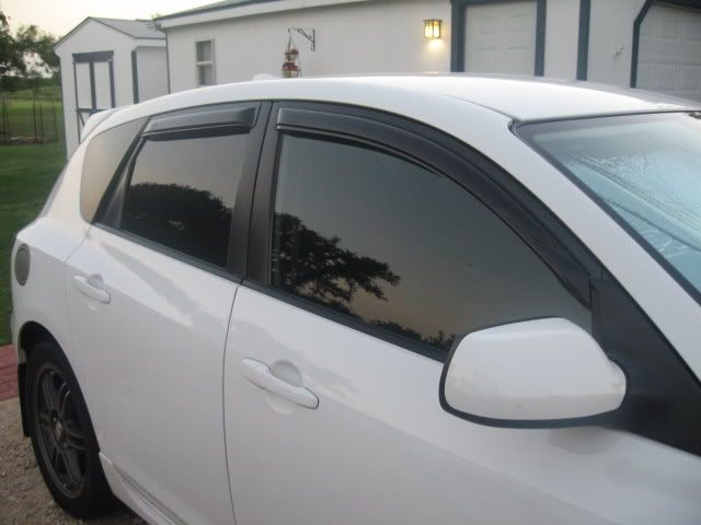

And though I would have preferred WeatherTech's (in channel) I installed VentVisor #94909's tonight.

As promised:

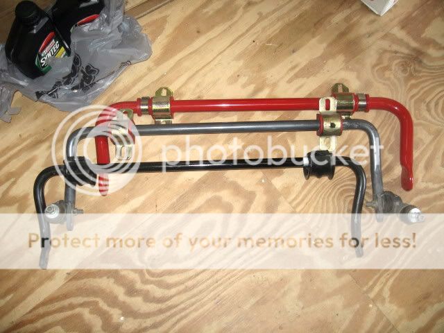

And today.....
Compare: Black is OE @ 20mm; Silver/Gray is Progess adjustable @ 22mm; Red is Racing Beat @ 27mm.
The rear end is DEFINITELY tighter. Move the wheel just a little bit and the car reacts! It's starting to remind me of my old, short wheel base Civic, w/o nearly as much torque steer.
I thought you might like like that RB rear sway! I LOVE mine! Really helps me in the slaloms when autoXing! What swaybar do you have on the front? Are you still rockin' the OEM? Switch to a RB front one too. You won't be disappointed!!(drive2)
Thanks for providing some pics and congratulations on a job well done! Was wondering what it would look like with the adjustable endlinks!
I'm runnin' the same bar (our mod lists ARE looking identical! EXACTLY the same, only different! (thumb)) with OEM MS3 endlinks--thought it would be a less harsh ride than with the AWR adjustable ones. Just not real fond of the white plastic "caps" on the joints of the MS3 ones. I would like a racier look than what the MS3 links provide. Those are AWR endlinks that you have, are they not?
Yup, still OE front w/the upgraded links and "yellows."
I was hoping to all but eliminate understeer by using the heavier rear bar and it worked!!
But I'm not so sure the front would be such a good idea for me. That is likely to add more understeer and make the car even harder to handle in slippery weather (no body yaw= bad, foul weather car, and this is my DD not my race car)... something I have yet to experience using only the rear.
Yes, they are AWR's, but I bought them, along with the bar, from GoodWinRacing. I've done business w/him (Brian Goodwin) before. His prices are always fair, in some cases the cheapest I've seen! He's small but we have formed something of a relationship and I'm comfortable doing business w/him. He's always treated me right, as well as getting back w/answers ASAP and that's important.

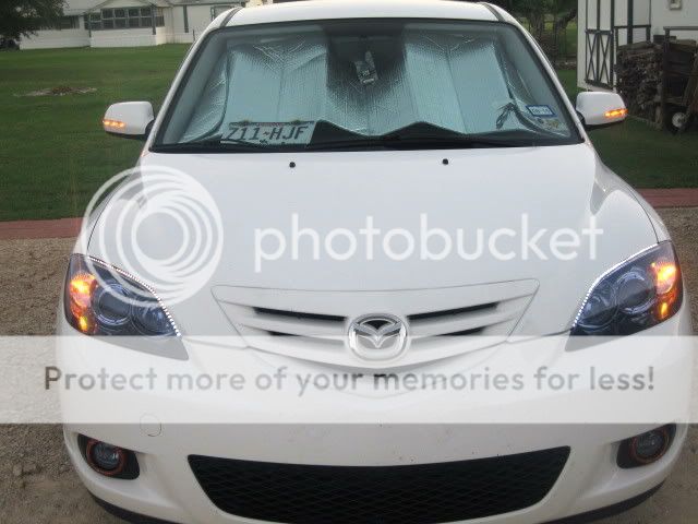

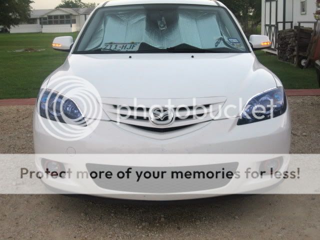

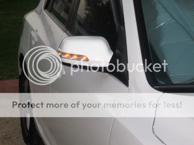

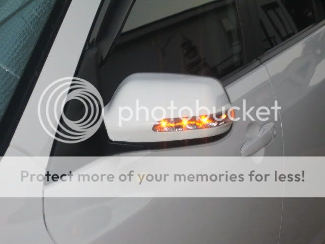

Oh, a little project I've been putting off... and waiting for the right time to do....
These, like many parts, have been sitting in my shop for the right time and motivation. I guess tonight was that motivation in-spite of the 97* weather.
Eventually I will replace the turn signal repeaters with these, and the repeaters will become additional running lights, but for now this will do....
Do those work as turn signals or just marker lights? I likey either way! looks super nice.(yippy)
