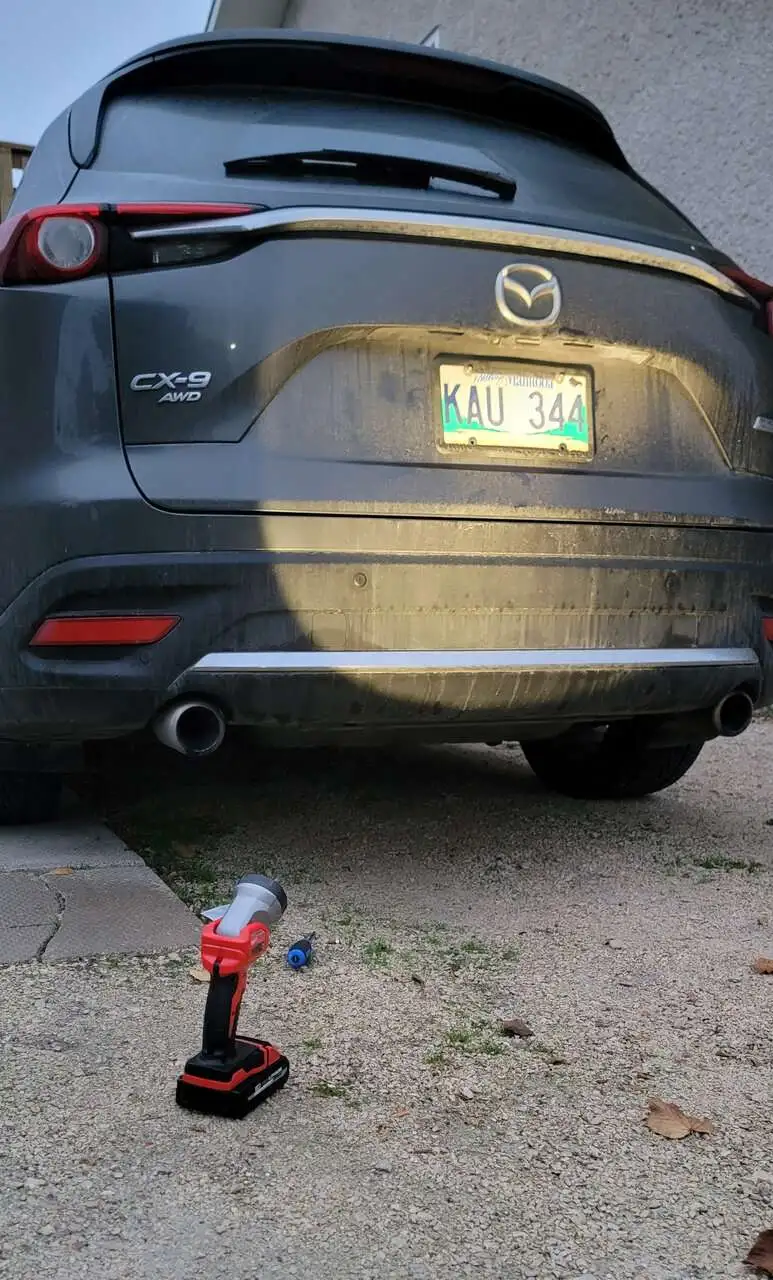

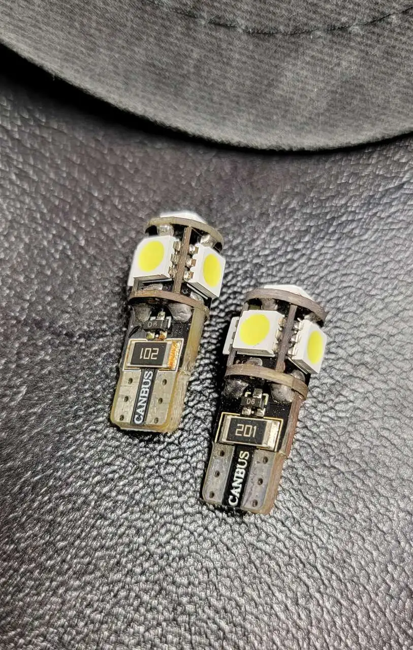

One of my license plate LED bulbs started flickering, so I swapped them out for a couple of spare LEDs I had lying around. The spares weren't any better (one was dead and the other was flickering as well), so I just removed them for the time being. Time to look for a new pair..

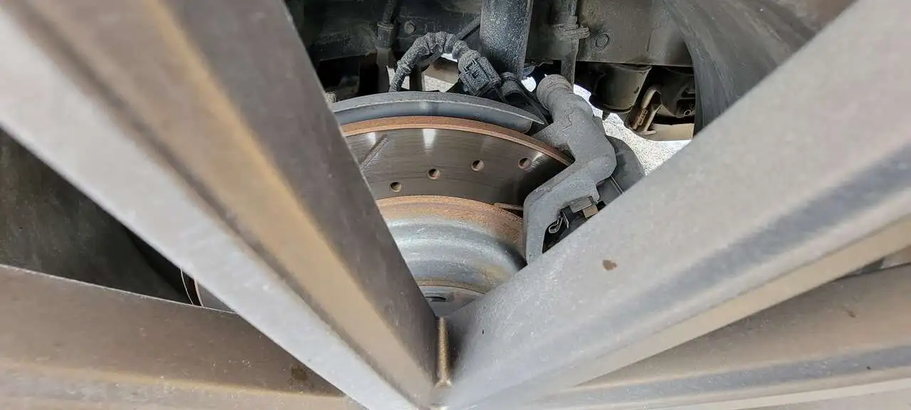

Let me go out and take a picture for you. The rotors themselves are perfectly fine so far, just a bit rusty, which I fully expected. I'll be taking a closer look at remaining pad life on the rears when I swap over to winter wheels (hopefully I don't forget to check), but so far, so good!
Thanks! Looks pretty typical after a winter in Canada.
Notice any more/less brake dust compared to OEM?
I have been looking at changing them out i am at 25%now so figure next year, if i dont change vehicles
Yeah pretty much how the front rotors look as well (on non-contact areas).
As far as I can tell, brake dust is about the same as the OEM pads, which were pretty low dust in my experience. If there is a difference, it's too small either way for me to tell. And as far as performance, they seem to brake about the same in regular driving, with a bit more bite during an emergency stop.

Replacement license plate bulbs came in the mail yesterday, so I popped those in. Also replaced the flickering reverse light LED bulb. Hopefully good to go for another 5 years.
