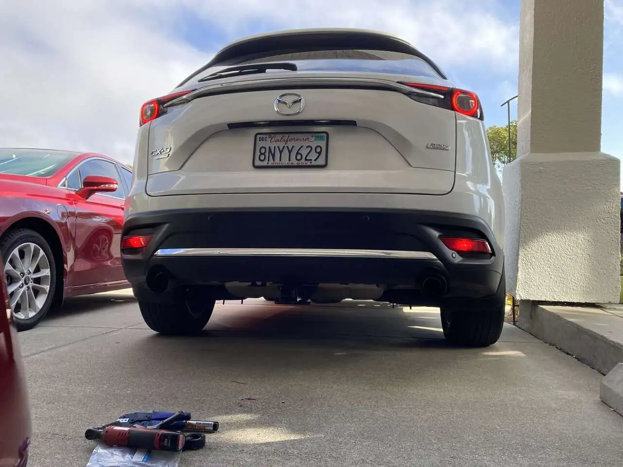

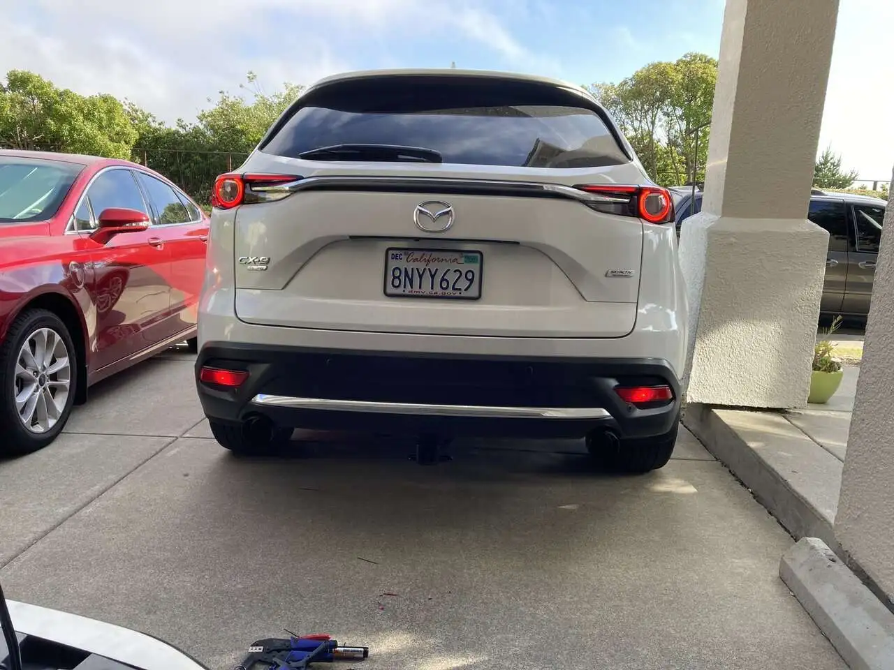

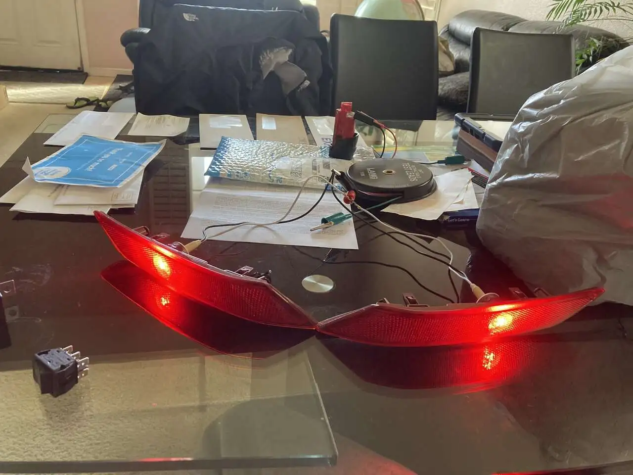

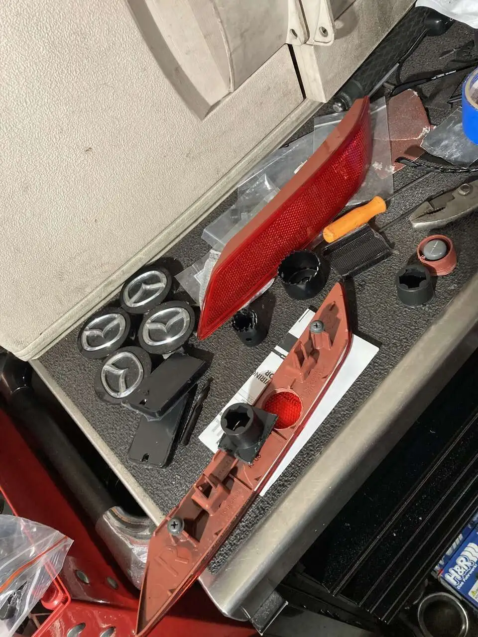

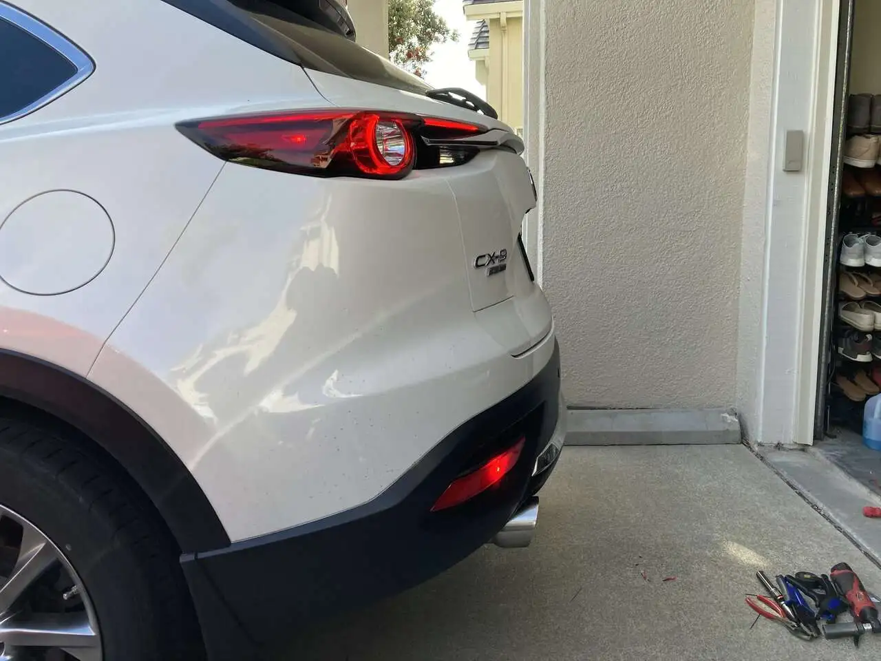

I made my own rear reflector lights. My idea came from, MGMGT16. Not as bright though. So I cut up the rear reflector and got a Jeep Wrangler side marker housing and also cut that one up. The reason I did that was so I’d be able to pick and choose what 194 bulb goes in there. I tried 921 bulbs but they were a hair too long. I also got a bulb socket for the jeep so everything matched up. I used silicone to seal everything up but now that I think of it I should’ve used JB Weld. If it comes apart one day that’s what I’ll do. For now, I’m leaving it. I haven’t mounted it back on the car yet but it looks promising! The bulbs in there right now aren’t bright but I have some brighter ones ordered coming in.

Probably way cheaper and still gets the job done! What did you use to make the hole in the reflector? Looks way cleaner than mine. Judging by the hole saw in the picture, I would guess that was used

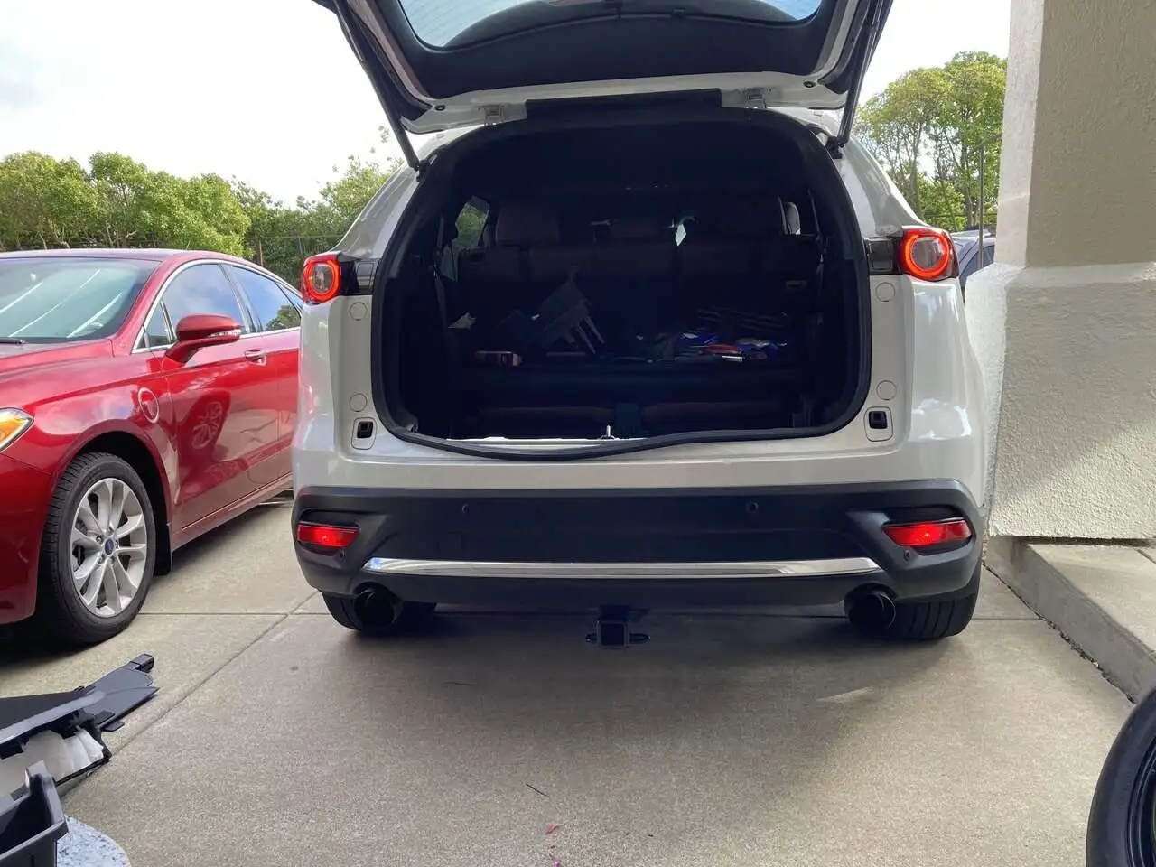

Yes it was a 1 1/4 hole saw. I know for sure it isn’t as bright as yours!! I can’t wait to see what yours looks like when it’s done. I’ll just play around with some 194 LEDs for now. Seems like they’re bright enough for me now though with these new LEDs I picked up. Here it is on the car currently. I purchased a Curt trailer hitch harness and tapped into that. I didn’t want to really mess with the stock wires. Plus, I just wanted the lights to turn on when the parking lights turned on. Stock, when the parking lights are off and you step on the brakes the halo part of the tail lights turn on so I didn’t want the reflectors to turn on with the brakes. Anyway, here’s the outcome.

Interesting that your halos light up as the brake lights, I wish mine did that. Looks much nicer. On the 2018 and earlier, there's a small LED cluster near the outer edge of the halo that lights up instead. I had no idea they changed it lol

That 1 1/4 hole saw was a much better idea than what I did!
Just so I understand, there is a parking brake wire on the Curt harness that you tapped? So these are on whenever you’re driving then? I went with the lower powered Diode Dynamics lights but I don’t think I’d be able to get away with running them all the time 😂
Looks like they have the little cluster on the taillights still so it’s interesting that Mazda chose to rewire them

On the wiring harness there is a ground, parking light, left signal and right signal wire. I tapped into the parking lights and ground. White and brown, just in case you get the same harness. White being negative/ground. So the rear reflectors are only on when the parking lights are on. During the day it looks like how it would’ve stock unless the headlights are turned on.

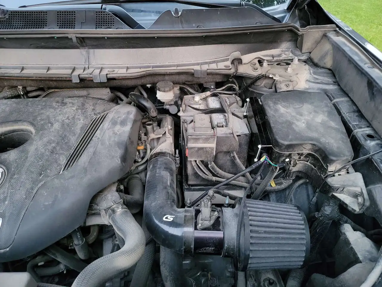

Also swapped the CS intake back on. I missed the excessive noise :giggle:

Well, attempted to install the JB4 yesterday. Got it all mounted up, but got stuck trying to disconnect the MAP sensor on the front intercooler. The instructions call for removing the bumper, but I was hoping to avoid doing that as I didn't want to crack it (there's a bumper crack TSB and my car is no longer covered under the basic warranty). Instead I tried to go through the small space in the lower grill. I can see and reach the sensor, but no matter what I tried, I couldn't get it unplugged. There isn't enough space to get anything except my hand in there, and I can't see how the sensor comes out, so I gave up for now. But here's a pic of how I have it mounted.
A note - For the CX-9, the MAP connection wire could benefit from being an extra 12-18 inches longer for a cleaner install. I wanted to run the wire underneath the intake piping and across the engine, ziptying the wire harness to the existing engine harness under the engine cover. But if I do it that way, the MAP sensor wire is too short to reach the connector. Instead, I have to run the wire between the front of the engine and the fan, and it kind of just hangs there and looks sloppy. Maybe I'll look at different mounting places for the box.
