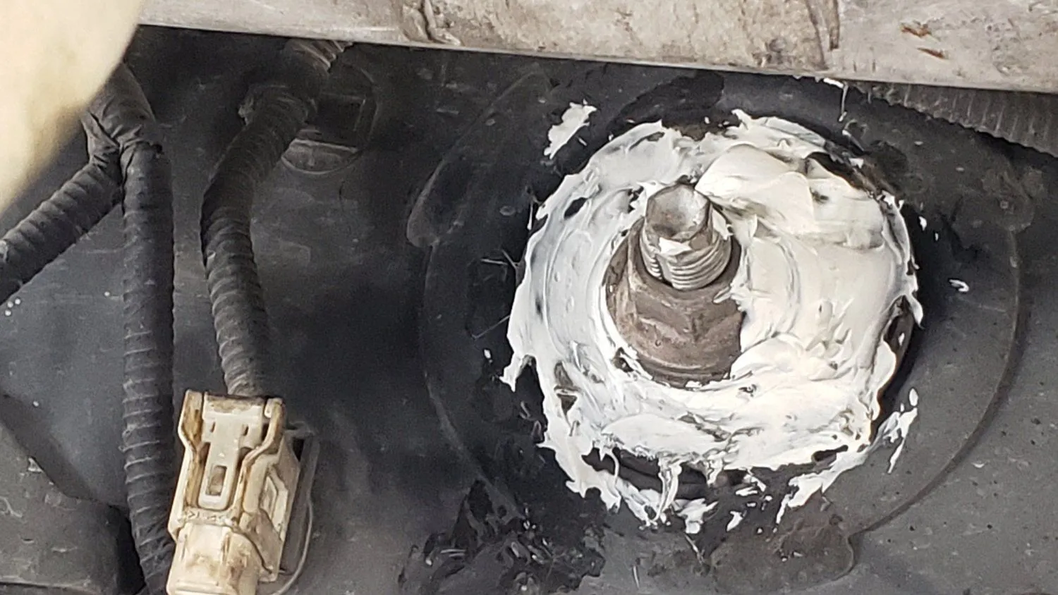

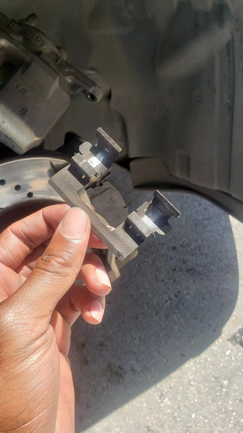

Replaced some anti rattle clips that I didn't have on hand when I changed the pads a while back. But I only bought the fronts by mistake. Also added more fill to the trash rear diff mount. It'll be filled eventually.View attachment 226323

Wouldn't bother. Not worth the effort to remove it (rear diff comes out). Filling around the already ripped mount makes it stiffer than stock anyhow.
I see! Hopefully this’s not a common problem for our AWD CX-5 and it’s trashed only because of your aggressive driving style. ;)
Well, it's just very flexible rubber. It's only a matter of time, if you look closely you might see tears in the "arms" that make up the mounting body.

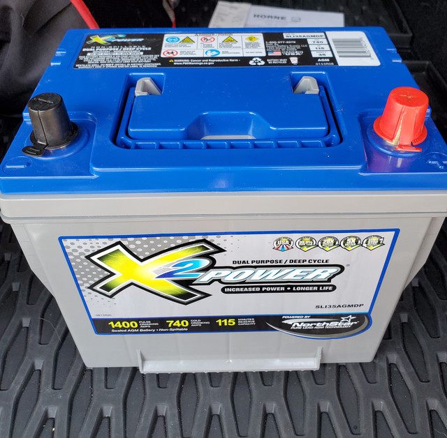

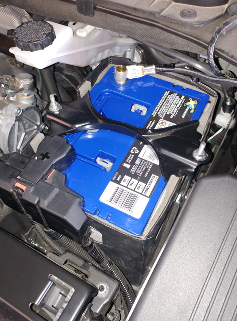

Time has come to replace the 2+ years panasonic oem battery, which has started the path to slow death in the AZ heat and not enough driving lately. Only 350 CCA measured even after full charge and the car starts very slowly.
If anyone is interested, the AGM "X2 Power" Group35 (Northstar re- brand battery) is a straight fit and size over the OEM.
Even the battery box fits like a glove on it.

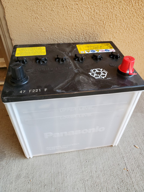

Hopefully this one will last much longer than the smaller/mini Panasonic that Mazda has put in. (pic below)

Not sure if your new "X2 Power" Group-35 AGM battery is having any troubles to perfectly fit the protective jacket for the battery? Interstate Group-35 battery sold by Costco has a pair of little edges on the narrow side, presumably for lifting the battery easier, but they do interfere the jacket installation. The Japanese made OEM Panasonic battery doesn’t have that, so as the USA made Mazda OEM battery sold at Mazda dealers.

What did you mean by “USA OEM Panasonic replacement“? If you meant a new Mazda OEM battery sold by the Mazda dealers, it’s no longer a Panasonic, but a USA made battery.

True. I had to add some distilled water on my OEM one this winter but it was a bit too late I guess to save it. The oem panasonic has a visible mark on its side (the battery box also has a cutout there for visibility) and you can easily see how much to add to each cell.
Also something else I noticed with the Northstar that I put in the car- the outer layer of the battery is from some strange abs material. It doesn't get hot, nowhere near as hot as the OEM battery. Engine compartment temp here reach as high as 160F in the summer. Which is a killer not just for batteries but all kind of plastics long term and the cx5 has a lot of those in the engine bay unfortunately.
