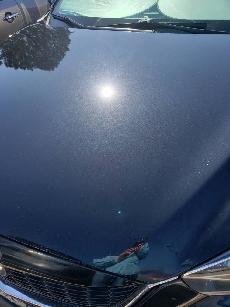

Got some cutting and polishing pads in and a 5 inch backing plate. Gave my HF DA polisher a whirl on the hood yesterday.
Did alright. I applied some pressure while doing it slowly with several passes in little sections at a time. Used Meguiar's Ultimate Compound. Still can see a bunch of little scratches, but I think overall is looking better than it was....minus all the hood dings that I have hundreds of. If nothing else, the swirl marks are at least gone.
Still need to give it a proper polish and wax. Going to try that Turtle Wax Ice Seal and Shine.

Wash, clay, Ultimate Compound with Harbor Frieght DA polisher and orange pad, Ultimate Polish with the DA and white pad, Turtle Wax Seal n Shine spray and wipe off. I will say the TW streaked something awful, but it was also hot as hell so I am sure that's why. Would probably work better in a temperature controlled environment of which I don't have. I hadn't clayed in a couple years, but it actually wasn't too bad, just the hood and a couple of areas on the doors were noticeably contaminated. The rest of the car came out mostly clean.

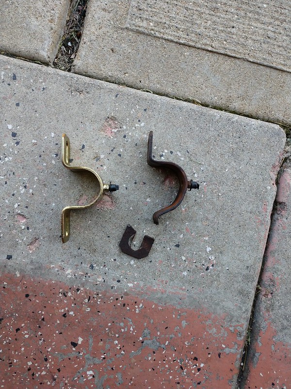

Pulled the wheels and dropped them off to get the new Altimax RT43 tires installed. While she was in the air investigated the intermittent rear clunk I have been getting. The culprit was the passenger rear sway bar bushing bracket. The front nut had backed off for some reason, the bracket then distorted and eventually broke at one of the mounting tabs. The clunk was the sway bar moving from one side to the other. Luckily I had the exact size bracket needed (can't even remember what I had bought it for) so after some fun got that installed. Changed out the muffler gasket, I had reused it a few times and noticed some carbon tracking at the flange. Also noticed a small hole in the RB muffler so put metal epoxy on that. Finally lubed up the adjustment fasteners for tomorrow's alignment to make the tech's job a little easier.
Picture of the broken bracket:
