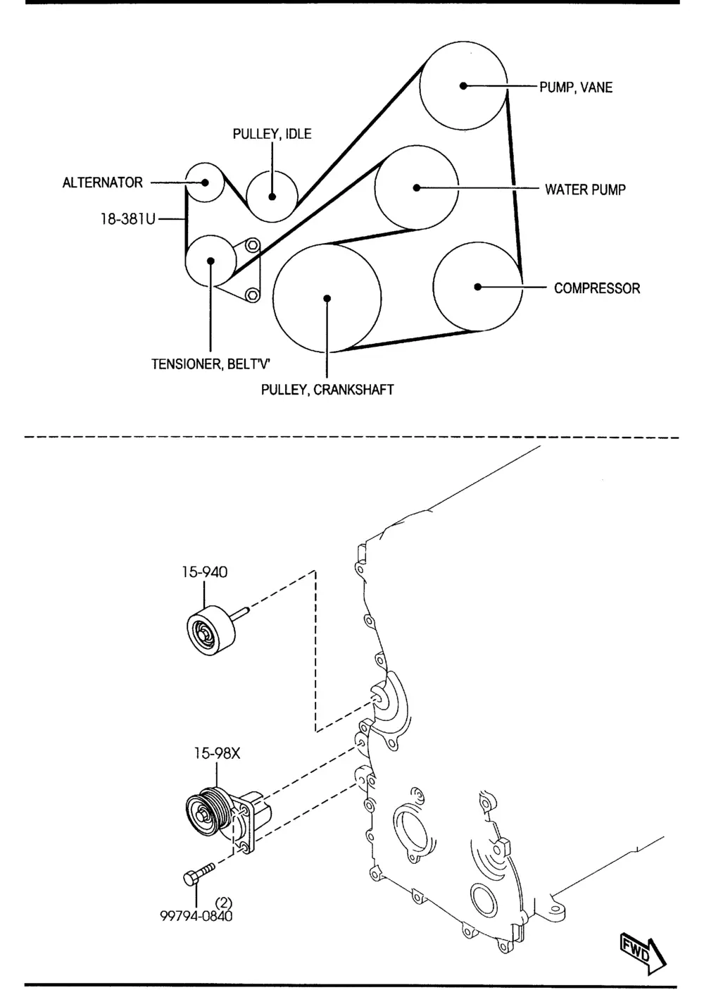

They fixed everything except that. How can i get them to fix it? I don't know what else to do. They said they drove another one on the lot and it sounds normal. Should i wait until it gets worse? Maybe i will just buy the damn thing from mazdaspeed motorsports. Anyone know which pulley is the tensioner? I don't know how to identify it.
Edit:// It's $88 through mazdaspeed motorsports. And here is the diagram on their site for those who are curious like i was.

Belt tensioner. you can check it with a 10 mm wrench. there are 3 marks on the tensioner. Turing clockwise should only go past 2 of the 3 marks, if there is any more travel the tensioner is bad
If it were bad, would you be seeing it move at all when the car is running? I think i see it moving a LITTLE when it's idling, but i'm not 100% sure. Just curious
I'll try to check it later today or tomorrow, wassup61 - thanks.
