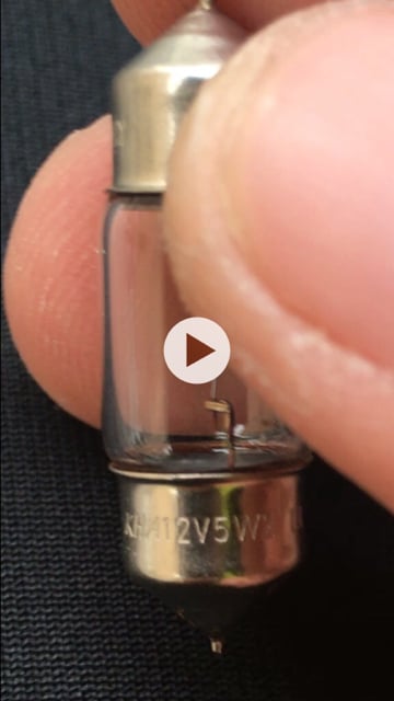

Here is a pic of the bulb :
looks like 31mm to me . try to make sure you are getting 5050 or 5630 led chip set . if they are not bright enough then your not gona be happy with any of them . if your are using ebay or amazon search 31mm 5050 or search 31mm 6530 . hope this helps .
