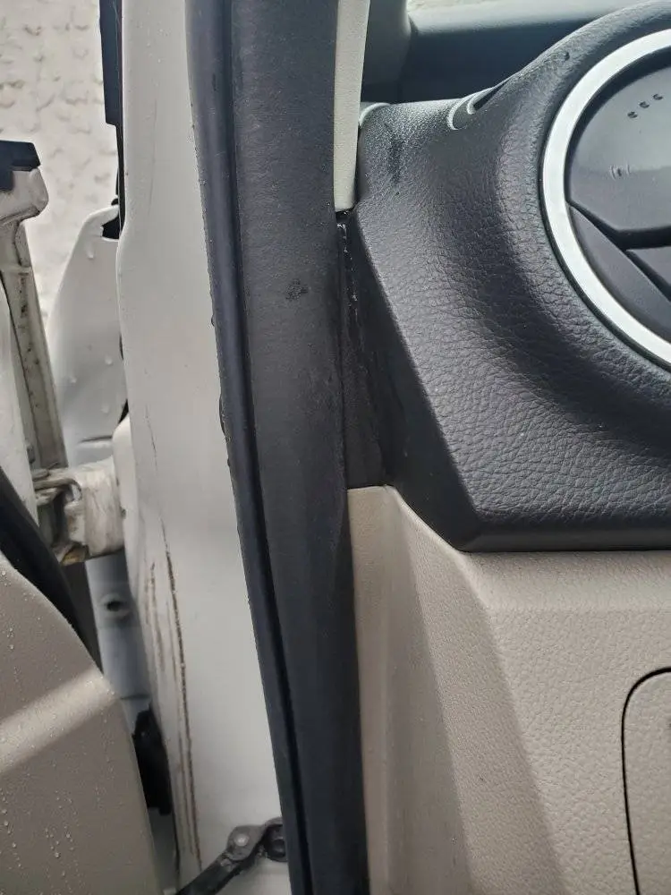

I have a 2010 CX-7 that just randomly started having a wet driver's side floor/mat. I've had the car for 10 years and never an issue yet. I think water is coming down the inside of the A pillar. See pics:

Well.... even though it is pouring rain, I just went out there with an umbrella and cracked the sunny. Tons of water in the drivers side pooling up in the little trough. Used keyboard cleaner down the drain tube, gave it a little blast, and then all the water drained out.
Fingers crossed this is the fix, but I will monitor and make another post later on to try and help anyone else who might stumble across this.
Quick update - Unclogging the driver's side sunroof drain fixed the issue of the wet driver's side floor. Also cleaned out tons of thick black goop from inside the sunroof. Hopefully this helps someone.
