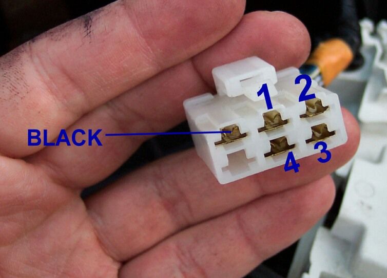

Probably your fan switch... Read the sticky above.
You can check the condition of your connector easily enough.
You can always do this !!!
I already check the fan switch, seems in good condition, nothing like your second picture.
Do someone have a wiring diagram that I can use to build something like you last picture ? Don't mind building something like this. Or maybe only using an ON/OFF switch, I can I do that, which wire to use ? The big black power one ?
Just in case you do want to install a switch,...
The fat black wire feeds the power to the switch then it is sent to one of the other four wires.
If you install four on/off switches. Feed the black wire to one side of all the switches and the other four wires to the other side of each switch.
That fat black wire is actually a ground wire... If any of your wires touch each other or touch ground you will not blow a fuse... The fan will just turn on.
And it doesn't matter if you turn on more than one switch at the same time... You won't blow anything up.
Make sure any switch you use can handle up to 12 amps... That's why the house switch would work well... They are rated 15 amps..
