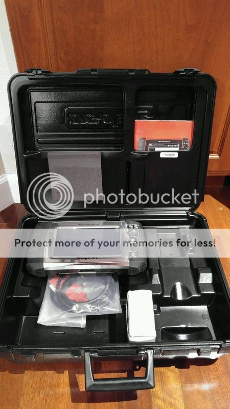

Generally the ecu needs to pass through three drive cycles (cold start to operating temp) consecutively and will then clear itself of present codes but could be seen as stored depending on your scanner. Here's my scanner...yawn... ; )
You got ripped lol

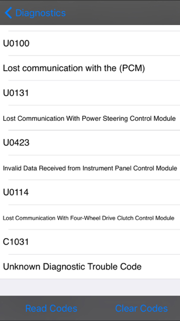

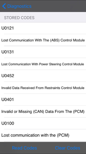

So a week after replacing the battery I'm having random security alarm going off at 4am etc. Battery was a bit low but not critical. Car runs fine. I got a code reader and there were no active codes. Some stored codes from the previous week mostly about lost communication with various control modules. It's at the dealer right now. So far they've ruled out alternator and battery problems. They think there is a power draw somewhere but can't find it. Hopefully they do better tomorrow. Of course this happens just after warranty expires.

So the alarm went off this afternoon. I went and tested the battery and it was at 12V and the car started normally. I'm beginning to think whatever controls the security system has gone a little screwball. Will be calling the dealer after Christmas.
**Update Towed to dealer, Dec 27, car totally non-responsive and battery down to 10.5 Volts. Got a code P1260 THEFT detected, Vehicle Immobilized, along with repeats of U0131, U0140, U0151, U0214, U0100, U0115, U0121 - I asked the dealer to check the connectors for corrosion as there is a TSB on it, but they are reluctant as its a USA TSB and says its not applicable to Canadian vehicles. C'mon dude, corrosion can happen to any car - especially with all the snow and salt its been exposed to this last month. Asshats! If they don't find the problem this time, I'm taking it to an independent mechanic that I know.
Problem diagnosed. Bad connector in door. There's a TSB for this but since I'm out of warranty, Mazda Canada won't fix. If there's a problem they should stand behind their vehicles not hope that the problem occurs after you're out of warranty.
