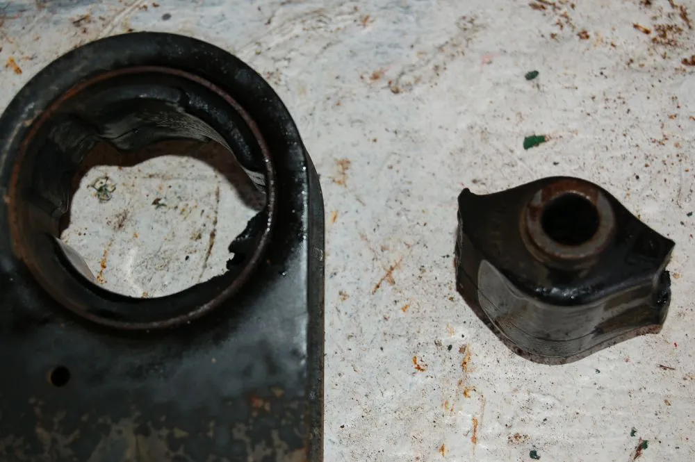

I just put in the SLS front mount. The stock mount after 111,111 miles was SHOT. Literally. In 2 pieces. And even though I still need to replace the side mounts, the difference is unbelievable. The Zoom-Zoom is baaaccckkkk!!! (cabpatch)(cabpatch)(cabpatch)(cabpatch)
Wow, it's pwned. Nice job on teh install.
If that's what you front mount looks like, I wonder how the rear mount looks? It was definitely time to replace it, and I know what you mean about the zoom zoom being back. Mine wasn't completely torn like yours, but it was well on it's way.
That's exactly how it looked. I took the bolt out, and that center piece literally fell out. ha...I hope the rear isn't to bad...I plan on doing the sides in the next week or so. I can't get a clear view of the rear or driver's side, so I really don't know what their conditions are.
Man, it's seriously alarming that the mount was that worn. Damn. An aftermarket mount is pretty much a requirement on these cars.
