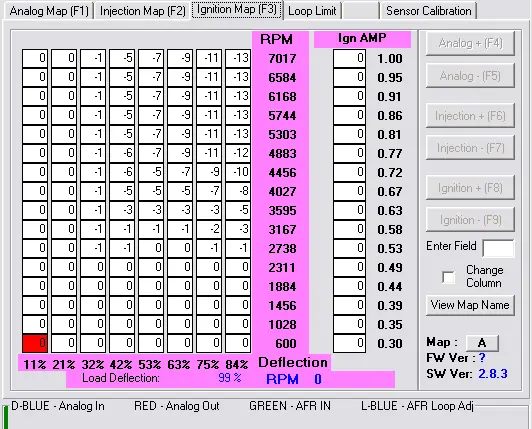

How do the Honda guys retard the boost? You said 1.5 deg. per psi. That sounds about right. How would a person add this capability to the MSP? Perhaps a MSD boost retard type thing or ????
A good piggyback or standalone will allow you to modify or control timing as needed.
Please see attached.
So, does the Stock MSP computer retard the timing with boost or no?
That's what I'm talkin about. What system is that?
On the load deflection, how does that correlate to boost?
Well, the MSP computer doesn't know "boost" persay, so it sets timing based on throttle position, RPM, MAF, etc.
SMT-6
Load deflection is simply throttle position.
