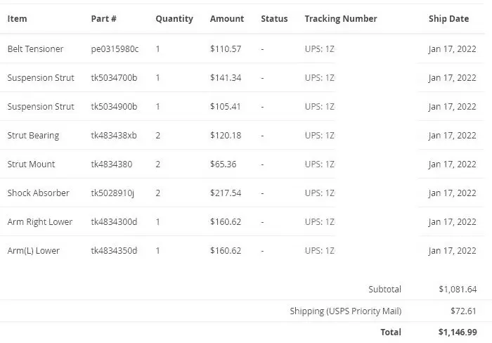

When I replaced the suspension on my 2017 GT these were the parts I ordered from Mazda Swag. I thought the price difference between the left and right strut was strange. It was an easy diy to replace. The hardest parts were removing the ball joints and I had to lift the engine up a little to fit my socket on one of the control arm bolts. I'm pretty sure all it needed was the front struts at 70k miles but I was planning on keeping the vehicle so I replaced other components as well. Then the weak head issue and the crazy used car market made me trade for a new 2022 GT.
