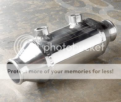

Just wanted to know if anyone was running one for the protege?
Ive been wondering about makeing one..
this is the one ive been thinking of
http://cgi.ebay.com/ebaymotors/TYPE...ptZMotorsQ5fCarQ5fTruckQ5fPartsQ5fAccessories
I pieced together a kit from frozenboost.com for my car. I don't really have much in the way of hard numbers to back up the performance, but I'm very happy with it so far.
im not trying to sell them just have one I took what i thought was a water pump from a prius and the small heat exchanger and got it for 58 bucks..
my goal is to have the shortest pipeing rout possible and have minimal lag and also look as stock as possible so I can pass smog..lol

anybody want to explain this water to air ic to me?
The hot charged air passes through a box with coolant passages in it with fins. This cools the charged air before it goes into the combustion chamber. Heres a youtube clip that illustrates it. This is a 2.0 ecotec supercharged engine but you get the idea. This setup has the coolant passages right in the intake manifold. So now the coolant is hot and is pumped through a intercooler. Supposed to be up to 20% more efficient then air to air setups.
You can see how the air comes into the supercharger were it is heats up from compressing it. Then passes into the intake manifold where the cooling passages are and cools the air as it enters the engine. A few different ways of doing it but all has the same concept.
