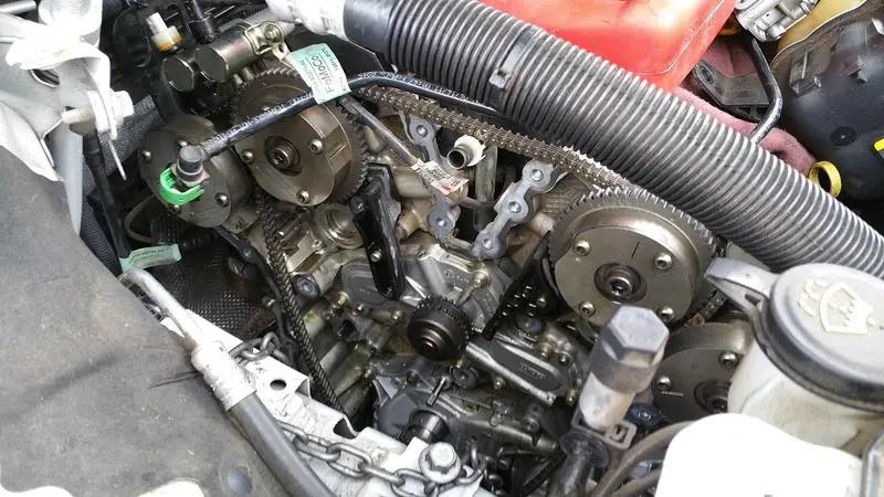

When we were coming home after the incident, I stopped at the dealer to check on the vehicle. Here are some photos of the tear down:

I guess I couldn't copy and paste the pic of the explorer that was torn down for the water pump. They didn't even remove the engine from the car and you can see the water pump. I am wondering if they have more space in the engine bay than the 9
water pump I hope the image should be attached.
