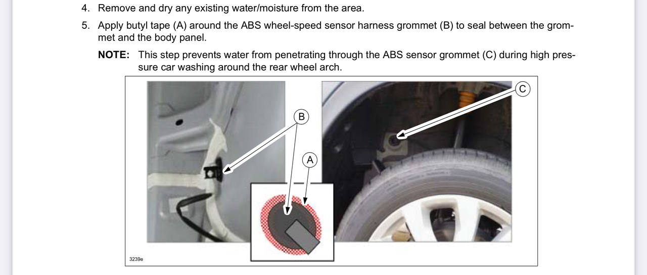

Does OP use a car wash with underbody spray? What is the model year? I realize FWD but pressurized water could make it into the rear via ABS wheel-speed sensor harness grommet.
That was a design flaw in 13-16.5 models that could take the rear differential out
“"The breather pipe grommet (A), located in the trunk, may be submerged in water that penetrated through the rear ABS wheel-speed sensor harness grommet (B) during a high pressure car wash. ”

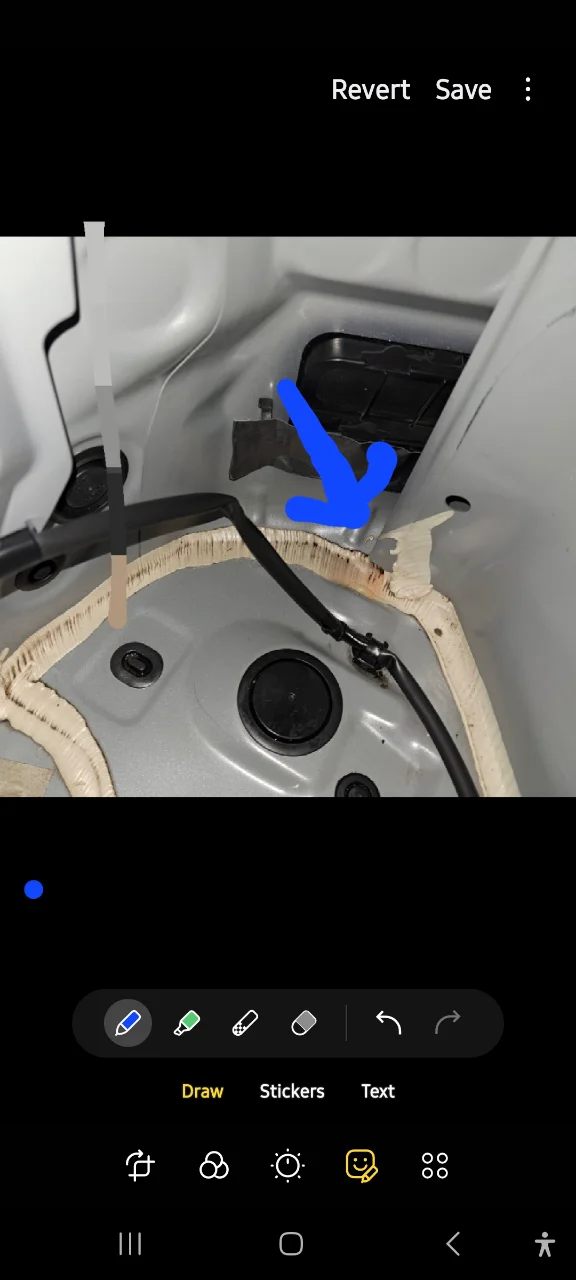

Thanks will try hosing the wheel well as water come in when driving in rain. Water is coming from where arrow is pointing and behind but can not tell where water come in in the first place.

Thanks, i will look at TBS and hose water in the wheel well from under and see. Water is pooling where the arrow is and just behind. If I know how I can reach the otherside, take panel out and silicone all areas. Thanks again.

Look around the ABS sensor bracket grommet. That is where intrusion occurs in TSB for the AWD models

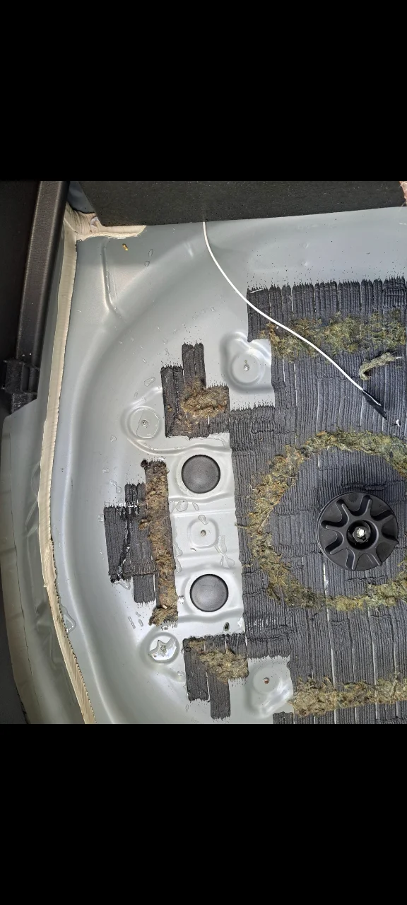

I caulked most of holes that tire moldings clips go in and leak is now minimal. Does someone have service manual to see why water that goes into hole on fender (where tire trim clips go in) leaks into the trunk?

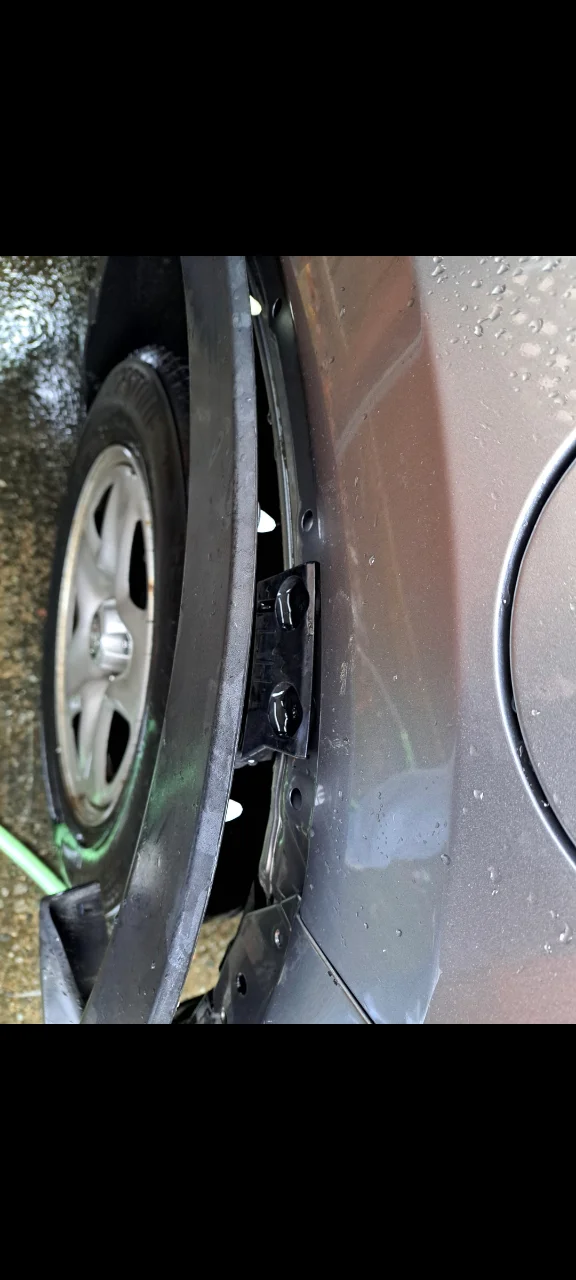

How can I remove rear tire well covers to see if I can plug any hole inside the tire well?

Remove all of the plastic push-pins holding it. There is a manual in the resources section.
Hi, would anyone has a diagram so that I understand how water that gets into wheel trim holes (above photo with white clips to hold black wheel arch trim)which leads to leak into trunk area? Because if I reach behind each clip holes, the back is enclosed. But then after sealing all the clip holes, I can see my white caulking inside from a photo attached. If wheel trim holes that white clips go in are not suppose to be wayer tight, where the water suppose to go when rain water go through these white clip holes, any ideas?
