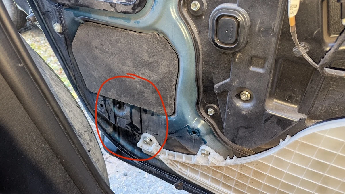

Update: I found the leak. Water was coming in through the driver side sliding door. And I guess my driveway is just enough of an incline to have the water pool up at the front of the car. I pulled the door panel off the sliding door and poured some water on the exterior side of the door. I saw water immediately coming out from behind this black foam thing, so it looks like I'll be pulling that off and resealing something in there.

Yeah I attempted to seal around and behind the foam with some weather stripping adhesive, and then glued a small sheet of plastic over the whole thing. I'm letting it cure for a couple days and then I'm going to dump some more water on it and see what happens.

I think it's normal for water to get into the door. There's drain holes in the bottom. But my problem is the water getting past that piece of foam glued to the inside of the door. Did you see the photo I attached?
Ah got it. I did see the photo, but my thought was that water probably shouldn't have been getting behind the door shell. Makes sense, thank you!

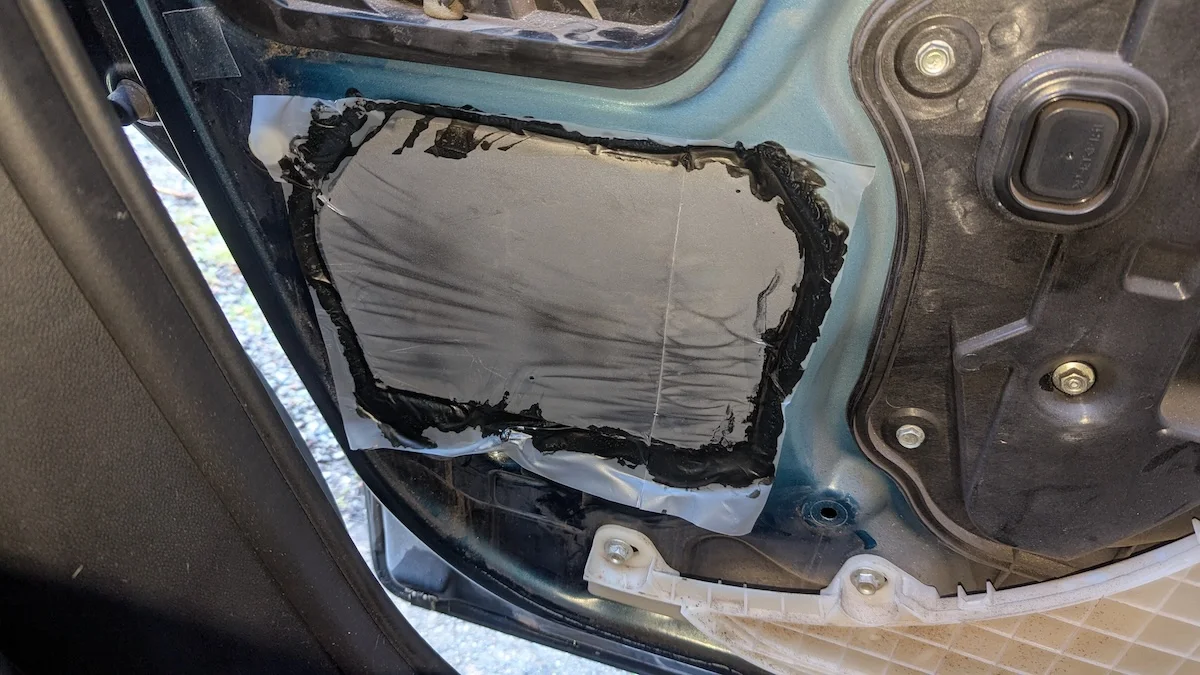

All right here's my uber-professional 100% OEM style door patch. I dumped a few gallons of water right on the outside of the window and I didn't see any more water leaking out of it. I did see a couple drops come out from behind the black plastic thing above it where the latch cables go in, but I'm going to leave the door panel off for a while and see if it leaks at all during some normal rain instead of the bucket deluge I subjected it to.
