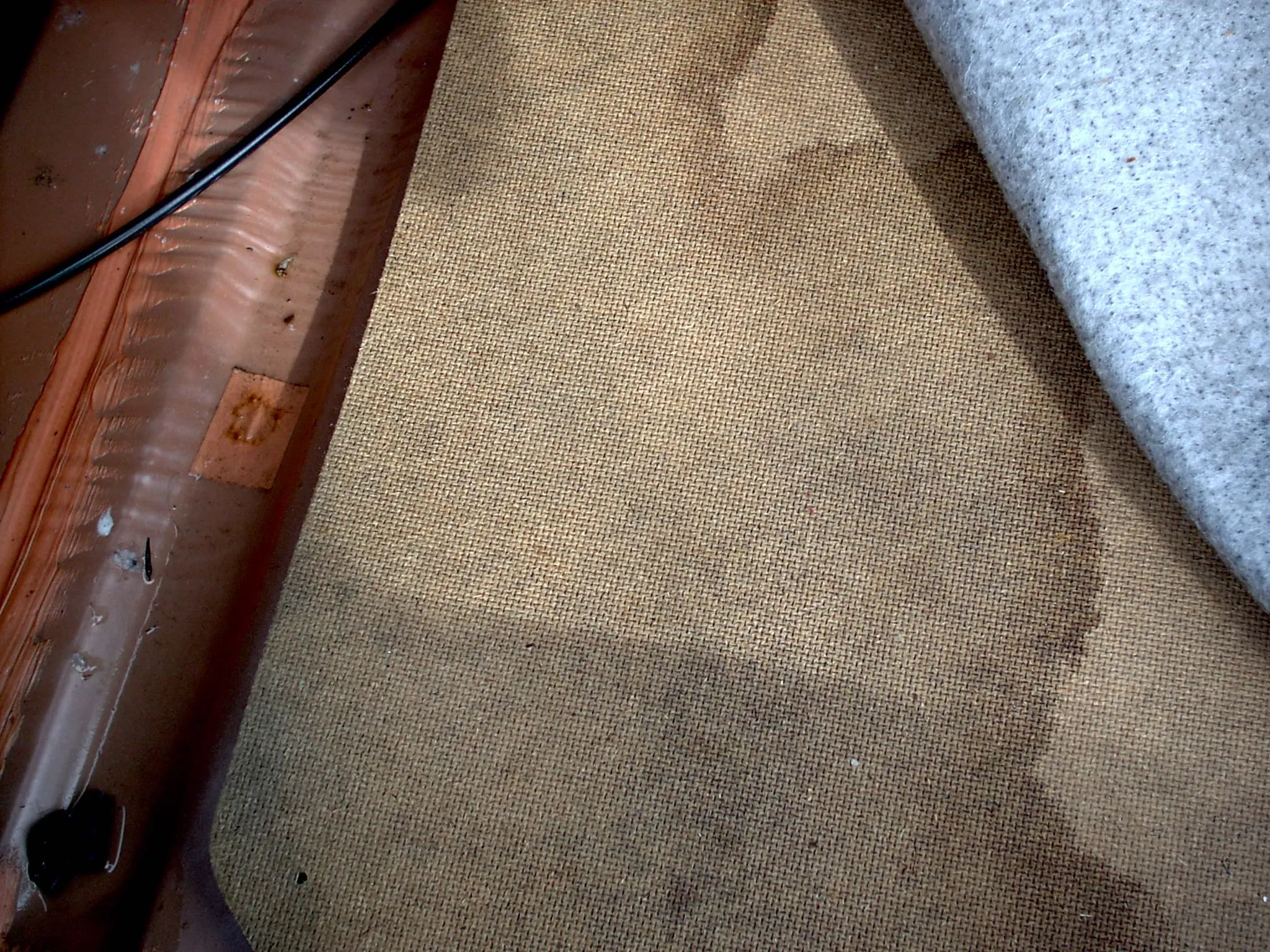

Anyone else having this issue? I got water in my spare well and the 2 side pockets of my tunk. Dont know exactly where its coming from, but there is a vent on the D/S of the trunk, down in the little side pocket. Anyways, anyone else with this issue? I want to find the issue before I take it to the stealership.
EDIT: Pics posted. The vent on the side is whre I suspect the water coming in, and based on the wet spot on my spare cover, its washing over from there.

I checked my seal (put powder on it then closed the trunk to make sure it sat snug) and my seal is fine. Im thinking its that damn vent it is coming in at.

It happens to me all the time. I checked my friends mp3 and his does it too. It ******* sucks and rusts up the jack and whatever metal is under there! I think it might be coming from the tail light housing holes b/c the right side of the trunk doesnt have a vent. I think the solution is to get some foam washer padding things for the taillight holes where it bolts to the car.

anyways, i climbed into the trunk while someone hosed down the trunk area. spotted several entry points basically far left and right creases of the trunk where the rubber seals are. we put this rubber like sealant thing all around the hinges and made sure the rubber seals were very secure. there has not been a leak since; unfortunately, we lost a jack, jumper cables, spare tire, ruined the sub boxes and wires, and the ground point in the car. we had to use those water vacums to get the water out of the entire spare tire compartment. the water was leveled to the top of the spare tire compartment (we were having a nasty rain spell and the car was parked outside the entire time). some of the water spread to the back half of the car so part of the back rug had rust stains and started smelling nasty. i had to sand down under the rear seats, spare tire compartment, trash everything in the spare tire compartment and jack. at least we finally got sun to dry the car out to the point where i could put the sealant and sand the rusted metal parts of the car down. good luck finding your leak. you better take care of the problem fast before you find yourself doing this kind of repair as well. peace out.
