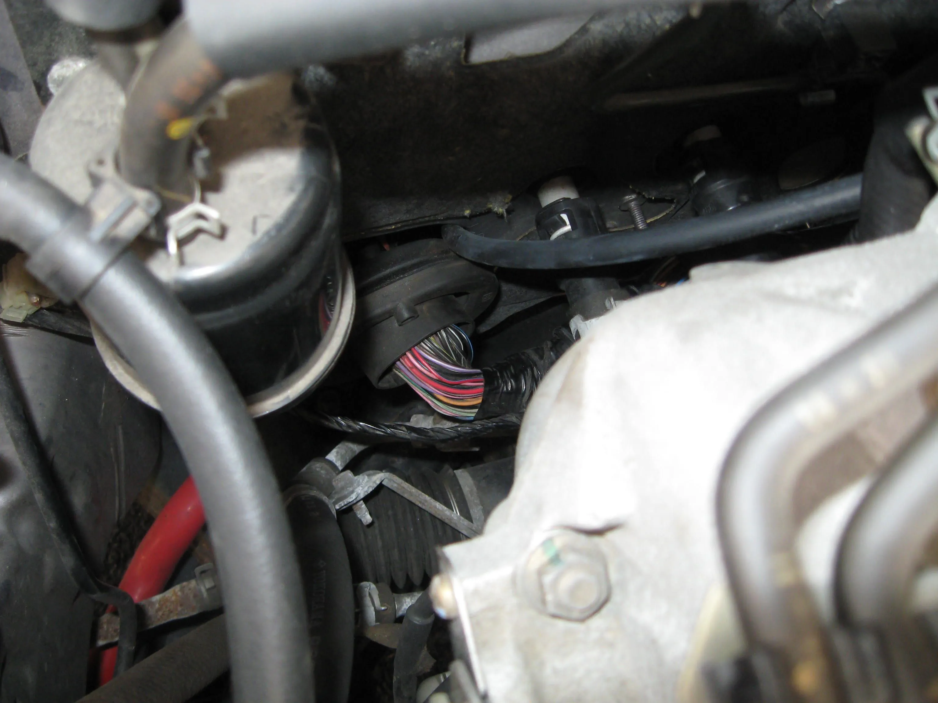

What about the seal where all the wires come in for the ECM? It's on the firewall and I could see that possibly being a problem. That, or maybe there are plugs on the floor? I can't really remember what it looked like under the carpet.
i do have a vacuum line there for the afc, but the leak was there before it was installed. are there plugs in the floor?
I don't think so - that means his engine compartment would be full of water.

I'm assuming when you drive in the rain water is gonna get up in the engine compartment. Plus the harness isn't to high up where water couldn't be thrown up there. How long has this problem been happening? I know I've heard other people with this problem before.
discovered the leak when installing the ss afc in august. i think everyone runs the vacuum line for the afc thru there and water gettin in doesnt seem to be an issue for them
