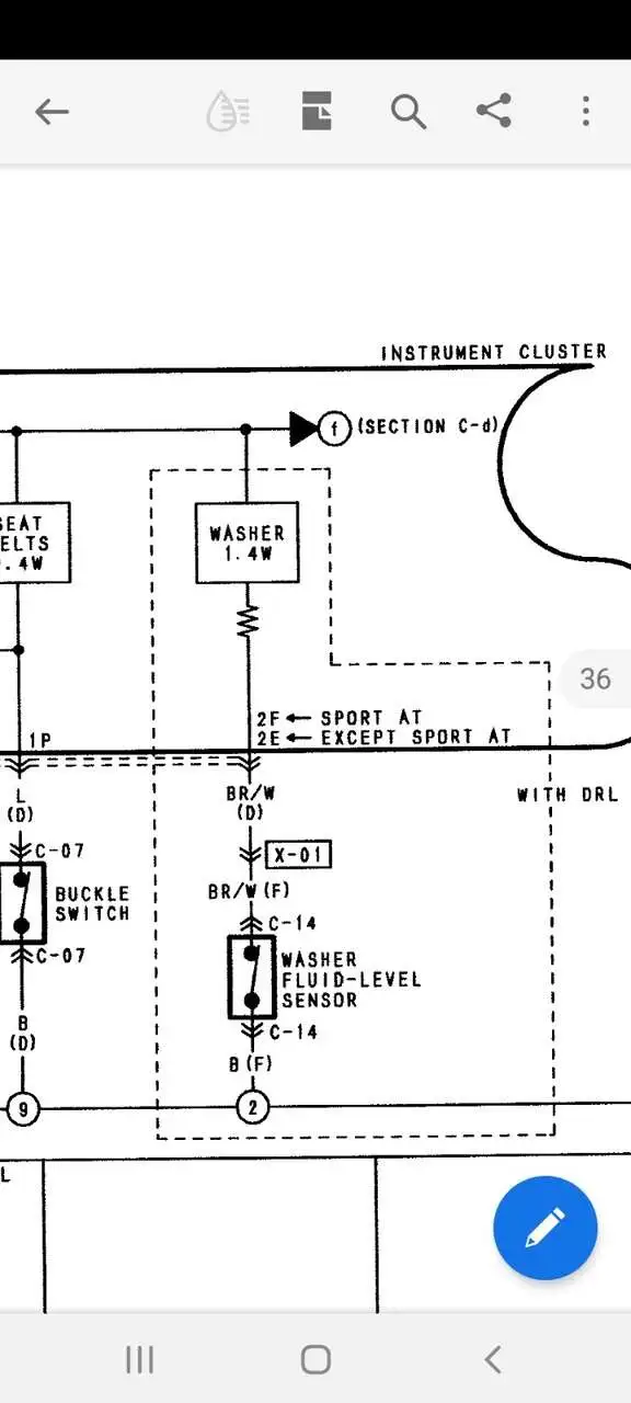

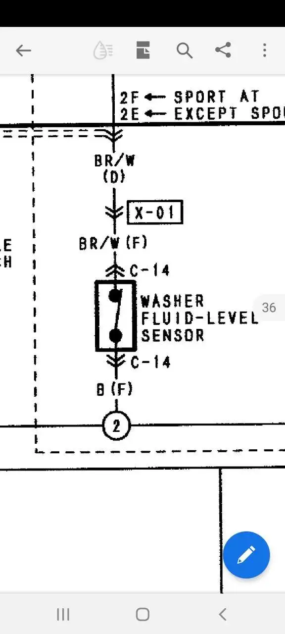

The extra wiring is probably for the float switch that turns on a "Washer Fluid Low" indicator light on some models of Protégé.
Those connections aren't necessary except to illuminate the light.
That gray connector probably has a brown wire with a white stripe and a black wire.
It is in the (F) front harness and goes through the X-01 connector where it joins up with the (D) dash harness to get to your instrument cluster.
Your car may have not have the low washer fluid indicator light, but was roughed in for it at the factory.
My car has the light.
The Canadian P5 has DRL. (daytime running lights)

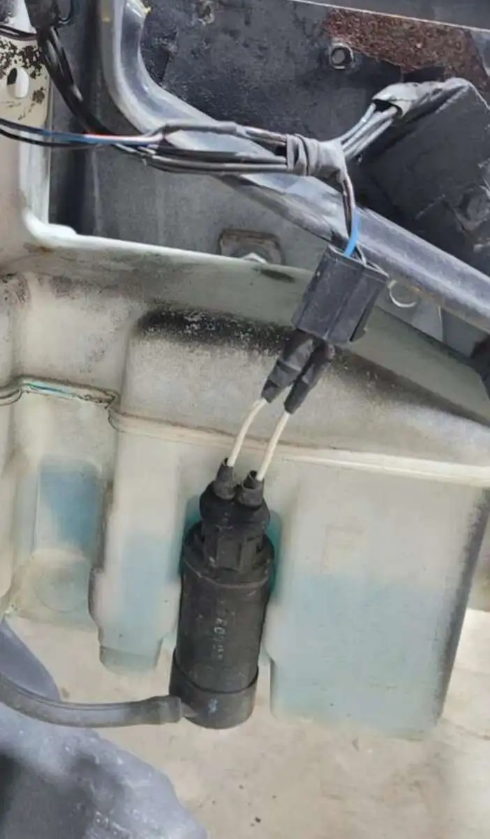

I don't think it's ever worked. I bought it for them a couple of years ago, and they've been complaining that the sprayers don't work. I had the bumper cover off and noted that the pump isn't plugged in at all, but there's no where obvious to plug it in.

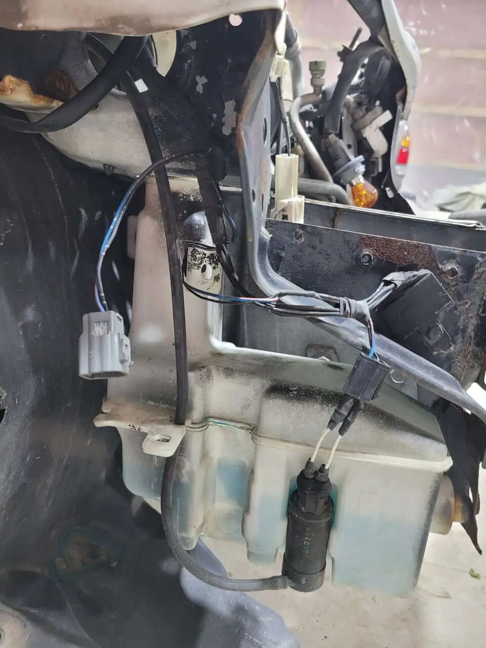

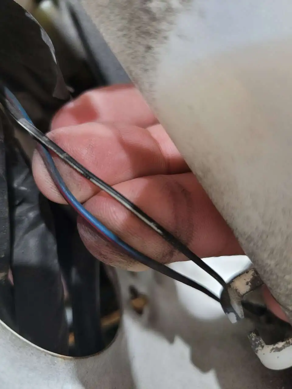

Here's what I saw when I pulled the bumper cover:

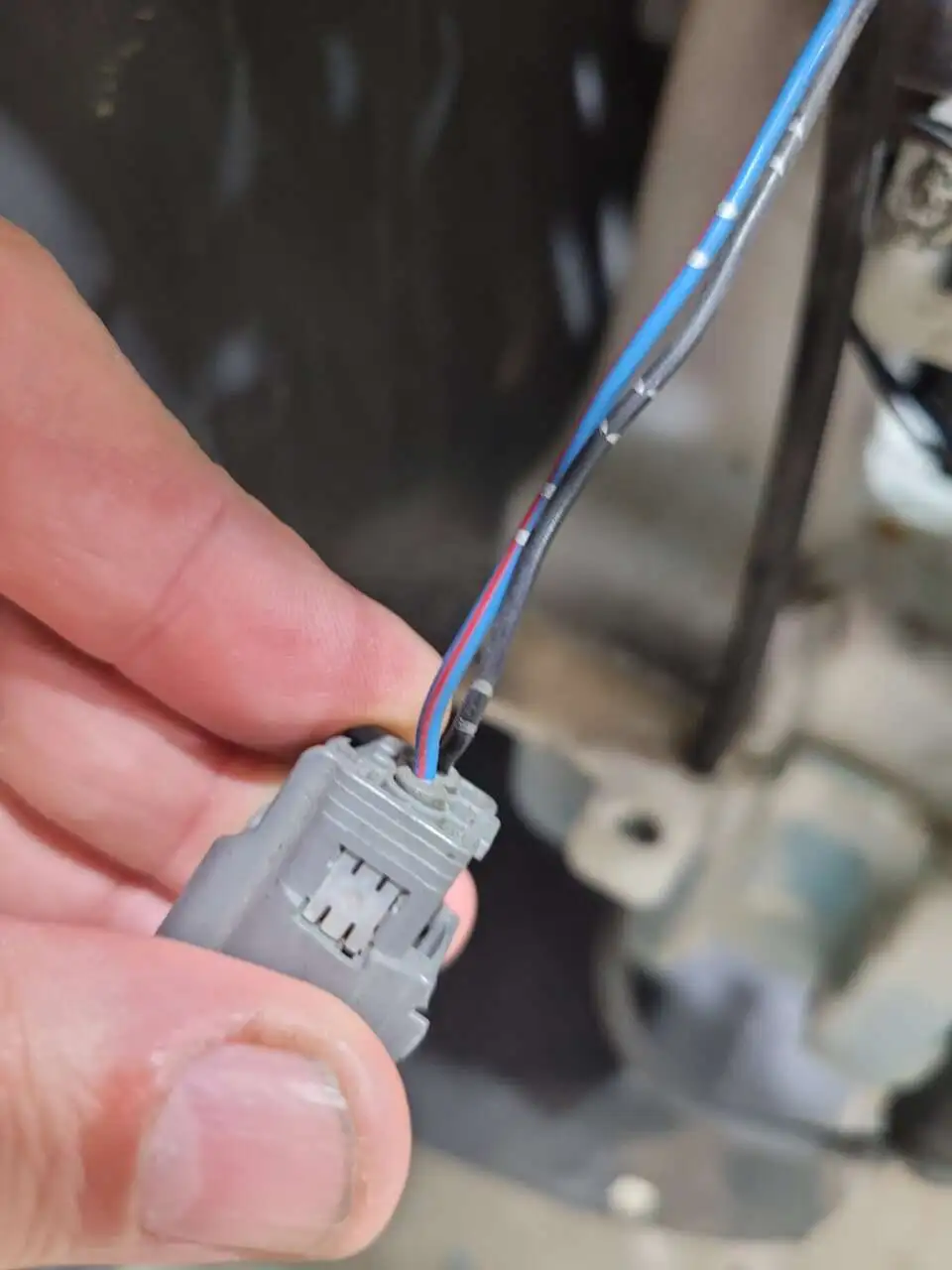

This gray connector was just dangling. One blue & red wire, one black wire.

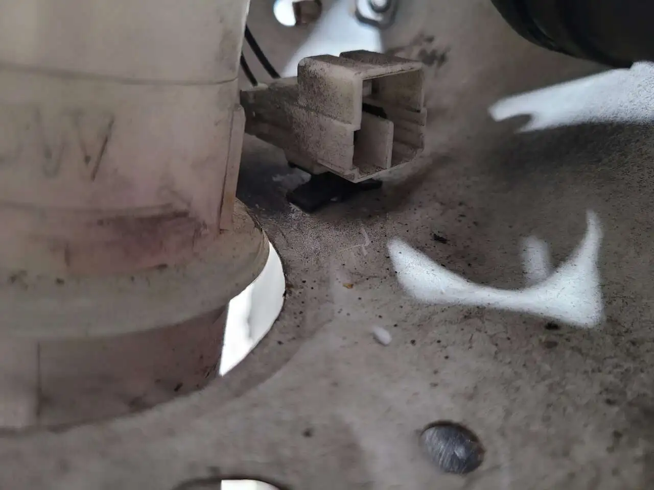

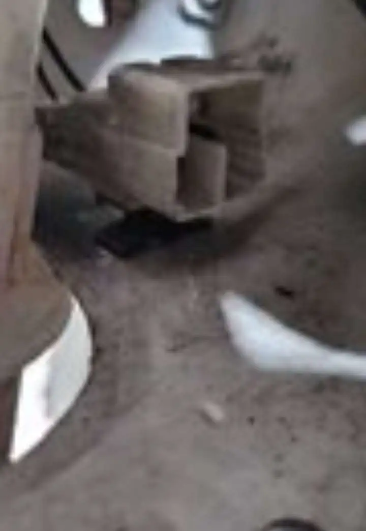

Near the fill neck is this unused white connector, which doesn't match or reach the other one:
It's got a blue & red wire and a black wire with a white stripe:

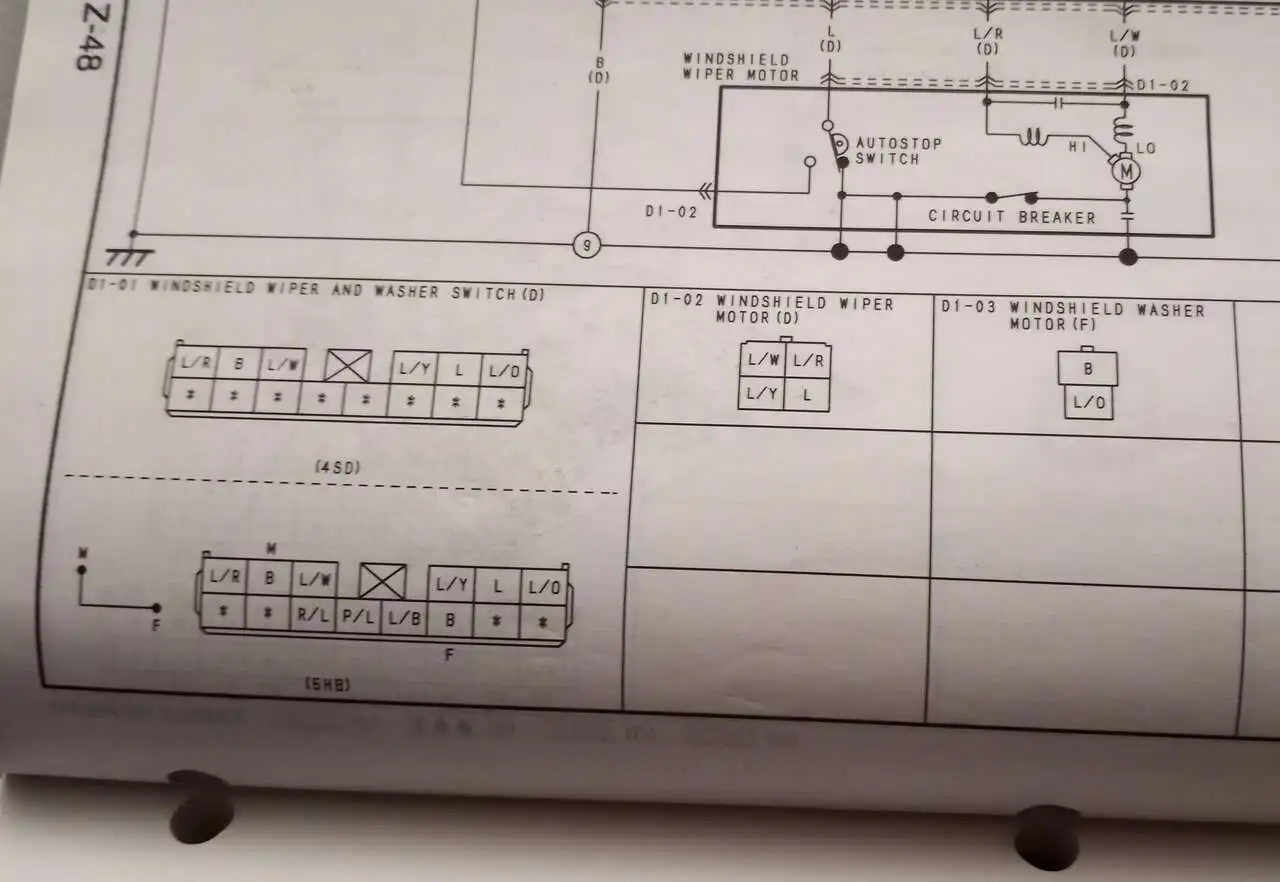

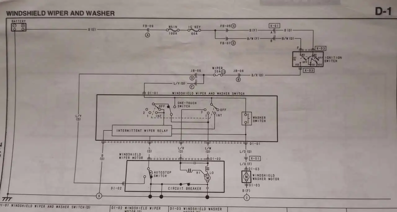

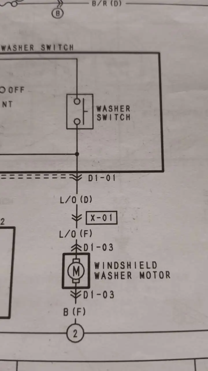

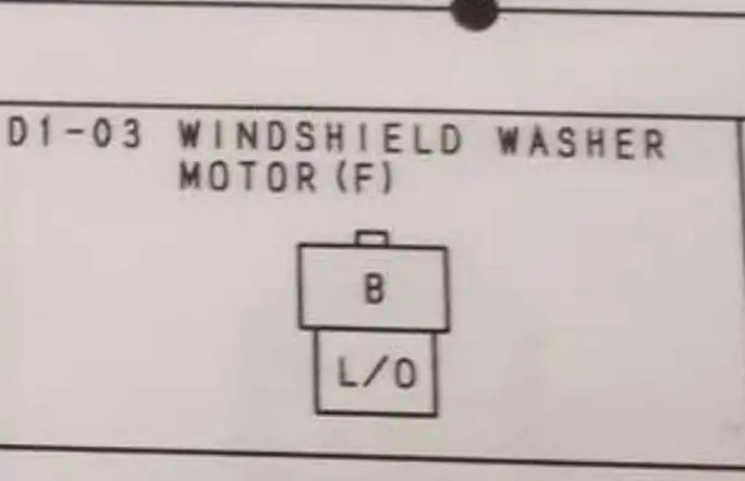

I've got this,..
It looks like the wires that power the washer pump motor are L/O
Blue with an orange stripe and B black.
Try to find those wires and connector and hook them directly up to your washer motor.
PS,...
I turned the book over to the 2002.5 diagrams, and the wires were the same colors.
Try to find this connector or it wires,..
Black wire and a blue wire with an orange stripe.

This kinda looks like the shape of the correct connector.
Check the wire colors on that connector.
I had the bumper cover off and noted that the pump isn't plugged in at all,..
This might be the proper connector??
Check to see if that blue wire has an orange stripe.
The black wire looks correct.
See if there is +12 volts on those wires when the sprayer switch is engaged.
Apply 12V to the two white wires and see if the sprayer sprays. (noting polarity)
You could install a switch or button directly from the battery, to the switch, to those two white wires to spray the windshield.
The white connector looks like blue/orange & black, the gray looks like it's blue/red and black. Hard to say for sure. Seems like they are the wires that should be connected. I'll check for 12v at the blue/orange wire when the washer switch is hit.

OK, so it turns out the washer pump was wired fine and getting 12v when the switch was hit. The problem was a bad pump. I have no idea what those two loose connectors are for, they both seem to have blue with red wires, but they seemt o have nothing to do with the washer pump.
Got a new pump and all is right with the world.
Perhaps those connectors were never used?
Mazda may have used the same wiring harness for all the different Protégés and some models had more features than others.
Perhaps the automatic and standard transmission use some different connectors?

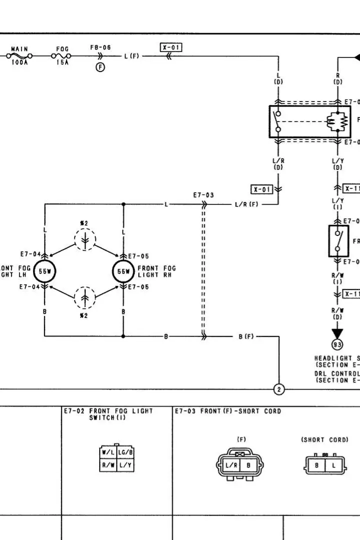

I think I've found it.
It's for the fog lights, and your Protege probably doesn't have fog lights, so the connector isn't used.
