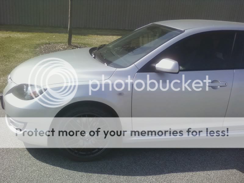

If you have ordered 18x7.5 enkei EKM3's call tire rack and make sure they are sending the correct offset wheel. I just spent 8 hours at tirerack only to have them put on the +38 offset ekm3's. And there is no way those will fit without rubbing. In their computer however they have those as fitting the speed3. So I just wanted to give people who ordered or had thought about ordering these wheels a heads up.
Edit- They do look nice, just need to get the correct offset.
they are gunmetal, the picture was taken with a bad cell phone camera and came out way darker than they are in person. Great looking wheels however, wheels/tires were just under 12**.

i have my stock wheels with winter tires on now. i am going to get the +45mm offset wheels. I went with Kuhmo ecsta MX tires 225/40/18 pretty cheap and have heard good things.
