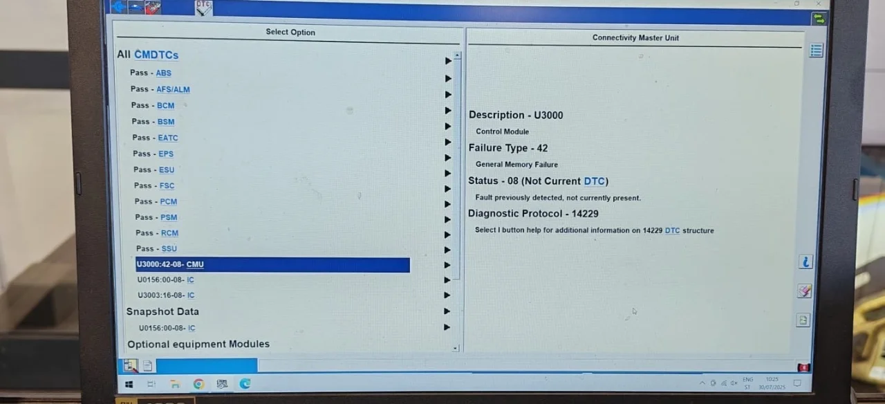

🧪 Diagnosis (done July 30, 2025):
I took the car to another official Mazda service center. They charged for diagnostics and provided the following DTC:
• Module: CMU (Connectivity Master Unit)
• DTC: U3000:42-08
• Description: Control Module – General Memory Failure
• Status: 08 (Not Current DTC)
• Diagnostic Protocol: 14229
I’ve attached a photo of the actual diagnostic screen

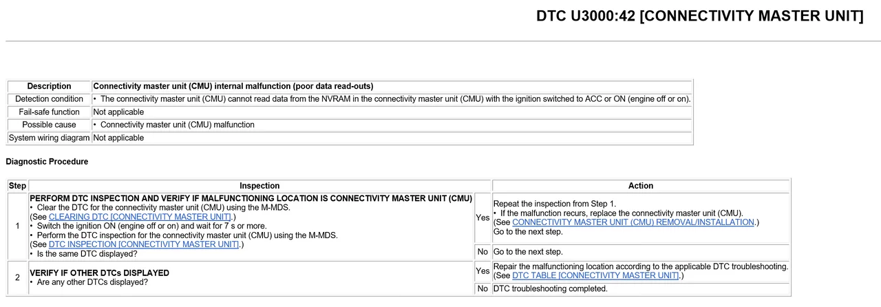

but this is what the shop manual says:

Is this official mazda service book? Cause then it’s point blank that guy from dealership is lying, with blind spot detectors etc
