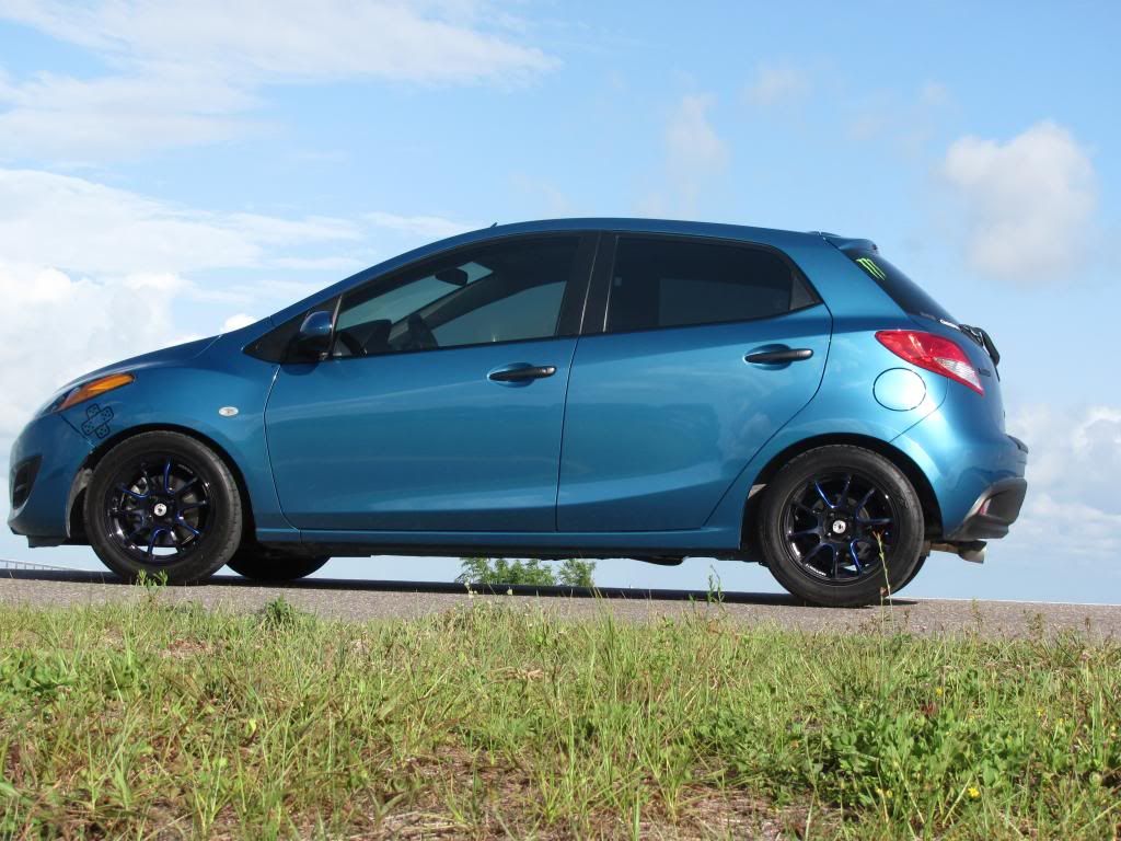

Those look nice. I'm still going with the Illusions, though, to get the contrast between blue and black (I already have blue lugs and valves, and blue calipers.
He should be fine with 15x8 +25. I'm on 16x8 +25.
Thinking about going 15x9 +25. But that would wait till next year.
