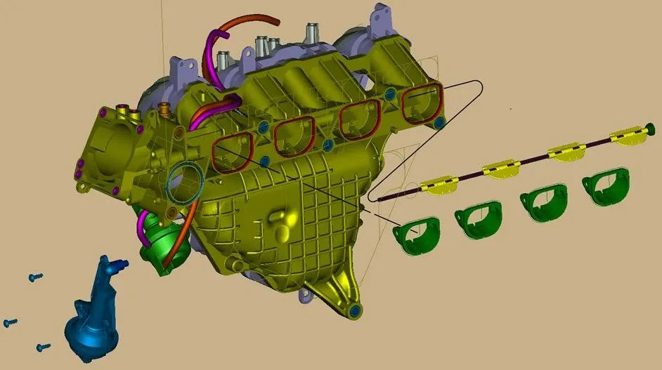

Could someone who has done the vcts removal help me out right quick?
(IN THE PICTURE)
Are you supposed to take the yellow flaps out, and then put the rod back in with the little green things.

Theres a few people over in this forum that have done it i thank maybe goldwing has done it. I read justa bout every piece of material on it at the other forums and theres just not any pictures of the mani and not really any detailed write ups. If I could get someone who has done it to just point out what i need to take out and what i need to leave in on the picture i put below then i think that would give me enough balls to do it.
I mean if I was to start doing it right now i could probably figure it out but i like to know for sure what im gettin into before i get to it. I think that all you have to do is take the flaps out and leave everything else there so the ecu thinks that its still there but i need to know the details and what to watch out for and such.

Replace the green inserts once you remove the shaft and flaps. You also need to replace the cap at the end of a the shaft where the actuator moves the shaft... So the actuator has something to plug into. I have a slightly lower cold idle than I used to when starting the engine when it's been sitting for a while.Once in a while it will still stall too. But after the first 3 minutes there's more available power than there was stock. Not a lot more, but it's noticeable. If you have an intake and exhaust it all helps the other parts to work better/more efficiently.

Yeah it seems like it just lets me to my torque quicker and doesnt really add alot of peak torque if any at all. I just did it saturday and it was so friken easy. I figured i was gonna end up gettin halfway done and then change my mind and put it back together. i just put the bar and the little spacer things back in without the flaps and hooked the solenoid back up and vwolla easiest thing ive done to my car since advance ignition timing. If you have never done something like this before i would suggest setting a couple of hours aside for the project at least 2 or 3, it took me a little over an hour. If you need more detailed instructions just say something and i will explain it to the best of my memory.

You should really go back in and remove the bar as it's still a big restriction directly in the middle of the flow of air. While it's better now that the flaps are gone, there is still something blocking air... the bar.

I was thinkin about taking the bar out today because all i hafta do is take the solenoid out and pop the white thing out and pull the bar out without taking the mani out, my biggest concern at the time was wether or not those spacers would hold them selfs in but i think they will.
