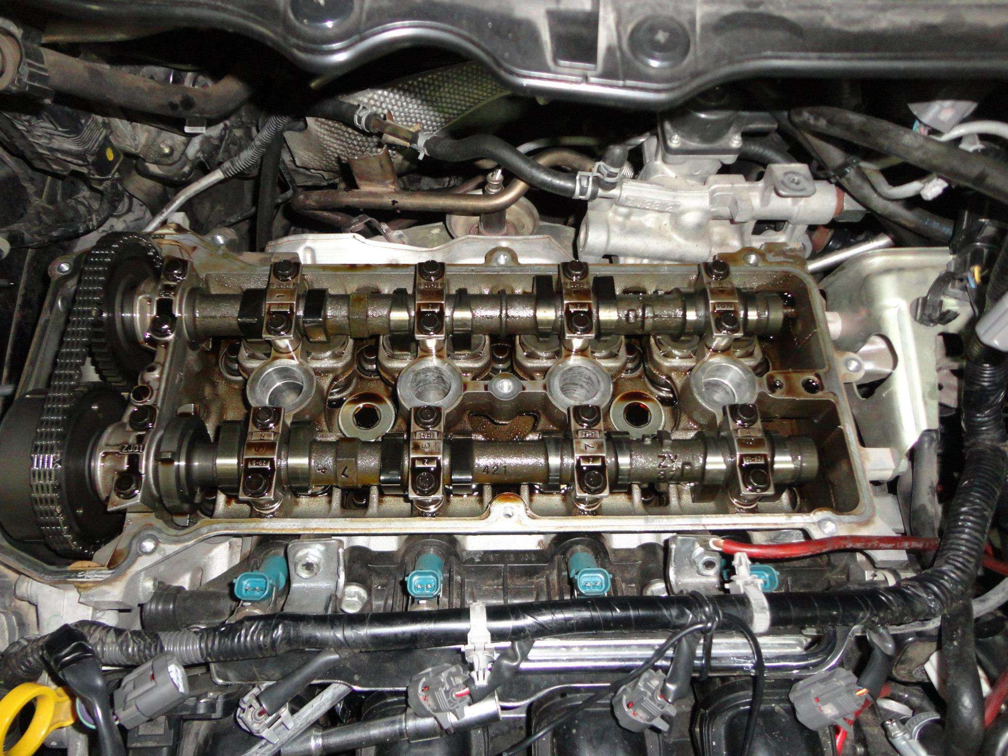

take a close look at the picture that i got when i was measuring the clearances
So, for a valve adjustment, we have to pull everything apart and change the shims? What fun ! ! ! <LOL>

As i said in post #9, the way of adjusting the valve clearance is by replacing the whole bucket/tappet.
From the service manual:
[FONT=Arial, Helvetica, sans-serif]19. Remove the tappets. [/FONT]
[FONT=Arial, Helvetica, sans-serif]20. Select a proper tappet according to the result of the valve clearance inspection and install it. [/FONT]

In fact, it will be much more expensive to replace the tappets/buckets than shims :)
btw, again from the service manual:

Because of the nature of the bucket tappets which our car has, it is normal to hear the valves in the first few seconds after a cold start up in the winter especially if you haven't start the engine for over 2 days .
