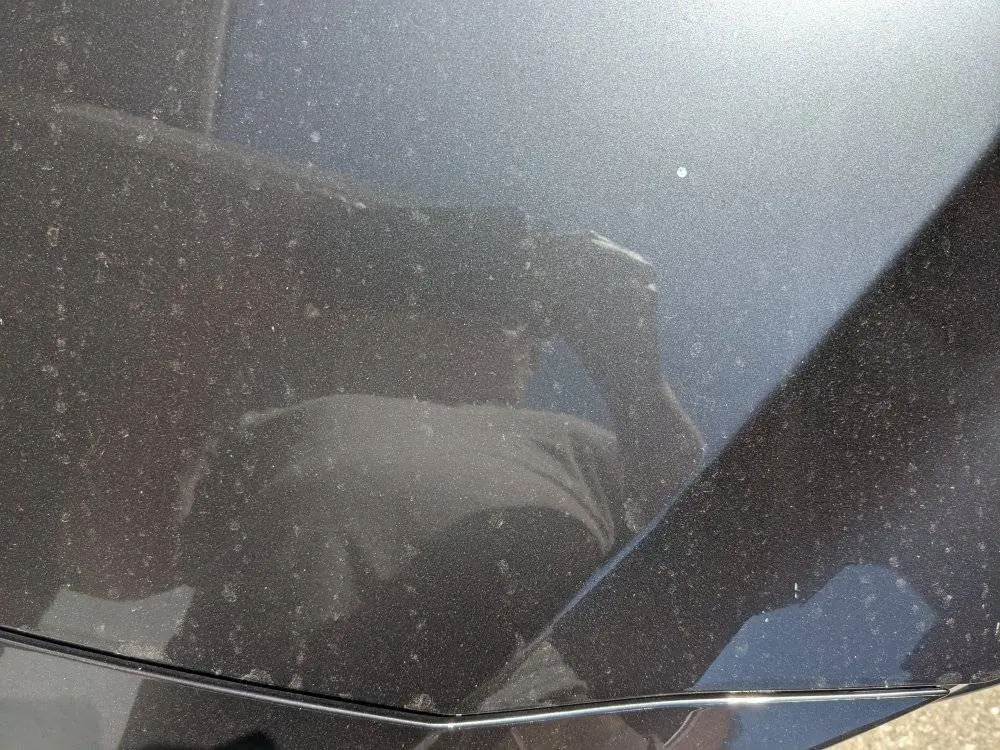

I have machine grey paint. Since the car hasnt seen ever been waxed and has 24k miles on it i have front to back micro scratches in the clear coat on my hood and the leading edge of the roof.
Will using a clay bar before using a restoration wax like meguiars ultimate compound make it easier to remove them with the meguiars? Or will i be taking way to much "workable" clear coat by using both and just give the car a through wash and then use the megiuars.
TIA

I'm not seeing any micro scratches in your picture, it just looks like dirty water spots.
Get a picture of the sun or flash light reflection after you wash it.
As for the clay bar, it will not remove micro scratches and it's actually not uncommon that clay barring actually induces marring (i.e. hazing).
What the clay bar will do is remove surface contaminants to allow a polishing compound work better/easier. The clay bar should not impact clearcoat thickness.
What you should do is wash the vehicle and do the 'baggie test' where you put your hand in a sandwich bag and lightly glide it across the paint. If it feels rough, the paint could use a clay bar to remove those surface contaminants.
After that, you'd have to assess if it needs a compound/polish or just a polish.
Once your polish, you still need to add paint protection (wax, sealant, ceramic...etc).

So, a few things. A compound is not a "restoration wax", it is an aggressive polish that is meant to reduce the appearance of deep scratches by "leveling" the clear coat. The picture you posted doesn't really show any significant marring, at least to my eye, so I would first start with a milder polish, like Meguiar's Ultimate Polish instead.
